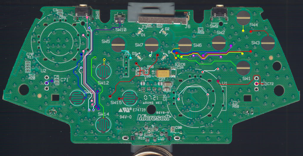

    I've just replaced both analog sticks in my 360 controller as they were a bit worse for wear. Put everything back together however I've managed to lift the solder pad for the Right Trigger signal point. So now when I play COD for example, it's trigger happy.
    Is there an alternative point I could run a wire to? Or any way to repair that point?

    Managed to sort it thanks to this diagram
    Ran a wire between the signal and the point next to "U1" and it's working fine. Happy days :victorious:
