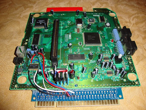

    I mod a model 2 genesis is not difficult but you need a sound amp at least I need it for the jamma candy cab because the audio was to low. Anyway here are some early photos of my jamma gen without the audio amp, the audio is taken from below on the mono solder point of the output connector.
  7. Daikath
    Daikath Active Member
    Mar 13, 2012
    25
    Hah very cool pictures and videos. Very informative, thanks. It's actually been quite a point of frustration with me, of how dutch law considers arcade machines as slot machines. When I was a kid I wasn't allowed in because I was too young, then that law got into effect and they all disappeared..
