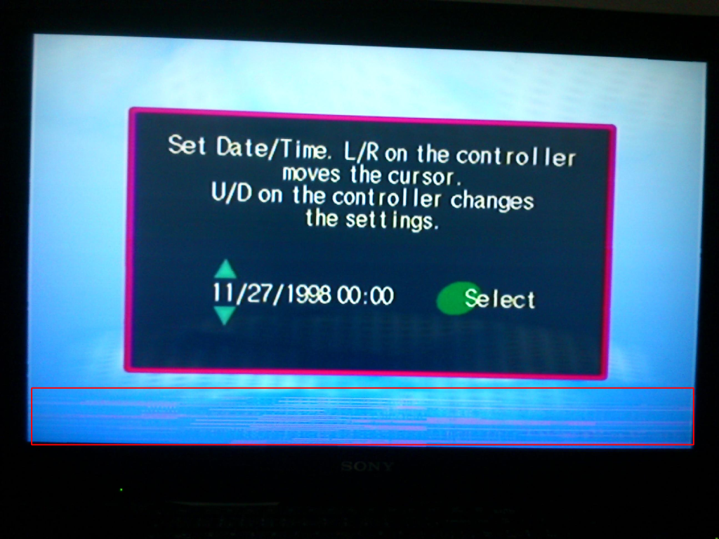

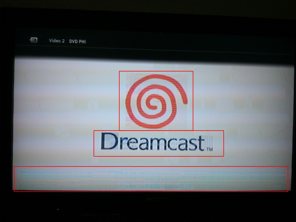

    2- The console has pictures problems, this problem can be resolved or the GPU will stop to work?
    Sorry by my bad english.Thanks for your attention!

    Have you cleaned the A/V out connections with some isopropyl? mine was only sending signals when the A/V cable was positioned a certain way until it cleaned the connectors. My laser is at the end of its life also, but I adjusted the Potentiometer and it's working a lot better now. That looks like it could be damaged VRAM although that's just my first guess.
