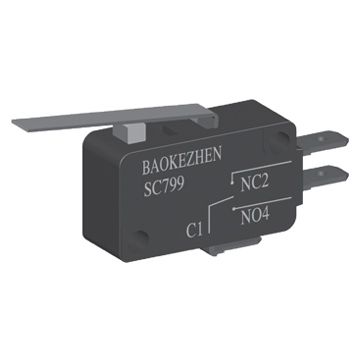

    One way you could do this is to connect a micro switch, like below, to the part of the drive door inside the console near the hinge which moves when the drive door is opened, so the switch is activated when either contact is made or lost depending on what the drive door does (you can wire the micro switch to either variation with some, or get either type). The switch will be wired to connect from ground>switch>LED. The positive end of the LED to connect to the DC voltage the console is using, with a suitable resistor to step-down the voltage to the LED.
