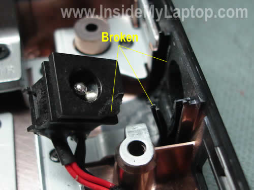

    The PSU connector is a block that slots into the base plastic. You then have a lead that connects to the motherboard.
    Using too much force will eventually make the plastic slots that the plastic power block slots into break and the connector will just flop around loose inside the laptop - with no easy way to connect power.
    example:
    Edit:
    Actually, that site above gives a decent solution.
    If you want to do it cheap and dont want to replace the whole base, do this:
    http://www.insidemylaptop.com/repair-damaged-power-jack-toshiba-satellite-l305-l355-laptops/

    Last time I checked this thread it didn't have any responses, so I went out and bought Loctite plastic epoxy. It worked like a champ. It was both the connector itself (which I bought a replacement on ebay since I didn't feel like splicing wires and soldering) and the base as well. It's similar to the picture Bad_Ad84 posted, but worse on both parts.
    There is no way hot glue or double-sided tape would've worked. There is too much force required to insert the plug and it would've dislodged glue or tape. I tried putty and it was immediately apparent that wasn't going to work, either.
    I used a two-part plastic epoxy, covered the bottom and remaining side support piece with the epoxy, and then when that was done drying I covered the top part yet again. It seems really stable and the laptop is up and working without a hitch.
