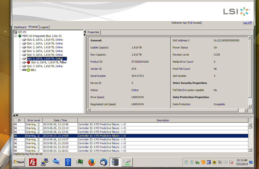

    The site data all resides on a Raid 6 redundant server. It has all the backups since 2006,
    as well as all the data from the old FTP that I hope to get online someday. It also has gigs and
    gigs of data from many dev houses.

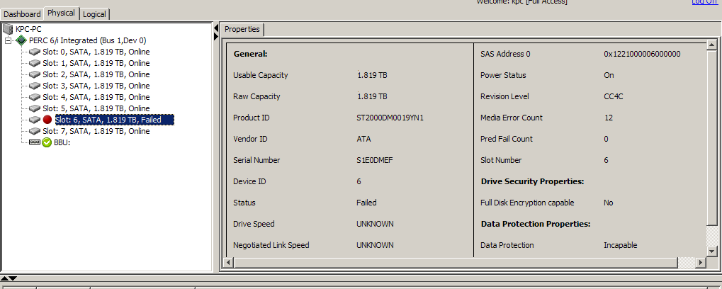

    I got emergency notice from program that one drive had failed completely, and the last parity drive was only 2% away from failure (reallocation almost used). I knew I needed to replace the dying drive, but the new drive sat in the box for a while as I thought I had time. The outright failure of the second drive was a shocker.
    After changing my pants, I immediately copied the most crucial data to an external drive, and then inserted a new drive into the array (it took 18 hours to rebuild). I now have to get another drive (2tb) and rebuild once more. The failed drive was a Seagate that failed something like a month after the warranty expired, and was one of the post flood Thailand drives that have been failing in great numbers. Selection was very limited at the time.
