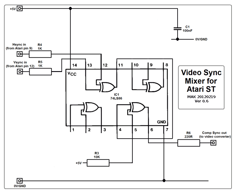

    Oh, I dug a little deeper and here's some super secret private conversation between @Ronnie and me - Shhh, don't tell @Ronnie!
    Basically is the same mixer for the Atari ST (see pic below) but for the TeraDrive and Mega PC you MUST leave out all of the resistors seen there. The IC mixes Hsync and Vsync to create Composite Sync. Also, the only VGA output pins to the monitor used for the TeraDrive and Mega PC are RGB, the GND's, and the IC made Csync which goes to the Hsync pin. Remember to only use these VGA pin signals because the Amstrad Mega PC for example also has audio pins and whatnot on its connector that will cause problems if connected directly. What I did was to get one of those cheap Chinese 2port VGA + Audio switchers (2 PC's to 1 monitor switcher) and I modded the VGA output of it with said pins and with the added Sync mixer chip, which believe it or not, is getting its external +5V power from a iPhone 4 USB AC adapter. This last is optional, as one can easily install the chip inside of each PC, but I didn't want to.
    Here's the IC Sync mixer schematic pic. Did I mention? Leave out the resistors shown there for the TeraDrive and Mega PC applications.
    Also, apparently there are a whole bunch of new and old LCD monitors that can handle both the 15kHz and 31kHz signals. My unit is a Dell U2410F but it looks like other newer Dell models like the SR2320L, ST2320L, ST2410, U2410 and some Samsung Syncmasters among others can do it not problem. Who knows and with luck, maybe you already have a compatible one at home.
    I haven't had the chance to test any of this and then I went ahead and sold my flash new Samsung screen... if any of this works for you, just shoot a thanks to @Ronnie! Best of luck! :)
