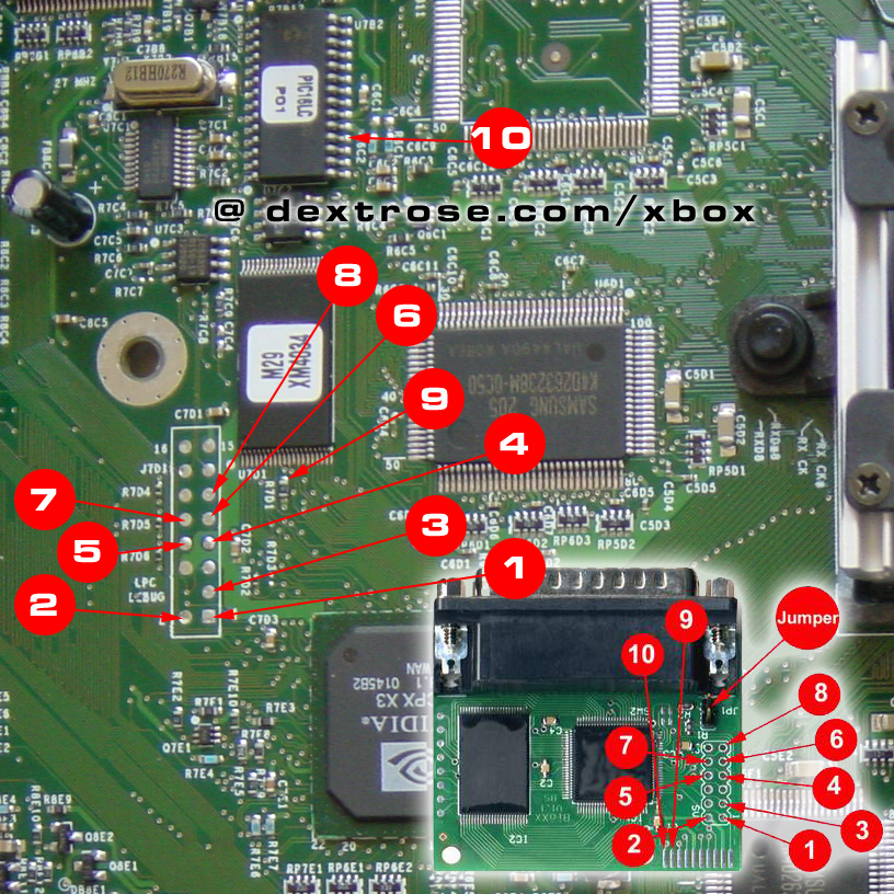

    If for any reason it has been opened (or it looks as if it has been tampered with) you should spot a few differences on the motherboard of the unit. First of all there is additional memory on the Debug (128Mb as opposed to 64Mb), there should also be a fairly large sticker with the motherboard details roughly under the actual numbers 7,5 & 2 on this following image.
    http://www.xbox-emulation.co.uk/News/dextroseXBOX8.jpg
    However, if the seller is local and you are able to touch the unit prior to purchase then why not just have the unit plugged in. You'll soon spot the difference in dashboard.

    Thanks for the additional info. I also read the video chip should be labeled "MCPX X2" instead of "MCPX X3". The dashboard is not proof enough, as I have a modded Xbox here at home which has a debug dashboard running. :)

    Though rare, some of the older chips have "MCP" instead of MCPX, just thought I'd throw that out.

    Perhaps it's not an indicator on it's own, but with all the other pointers (such as Debug Kit sticker) I'd say it would be a relatively safe bet even if the unit had been opened ;-)

    Well, I bought it after looking at the chip number, and everthing seems all right. Suddenly load all NeoGeo roms *do* fit in memory. :) It came with a much more colorful dashboard then I'm used to, maybe it was meant for journalists.
