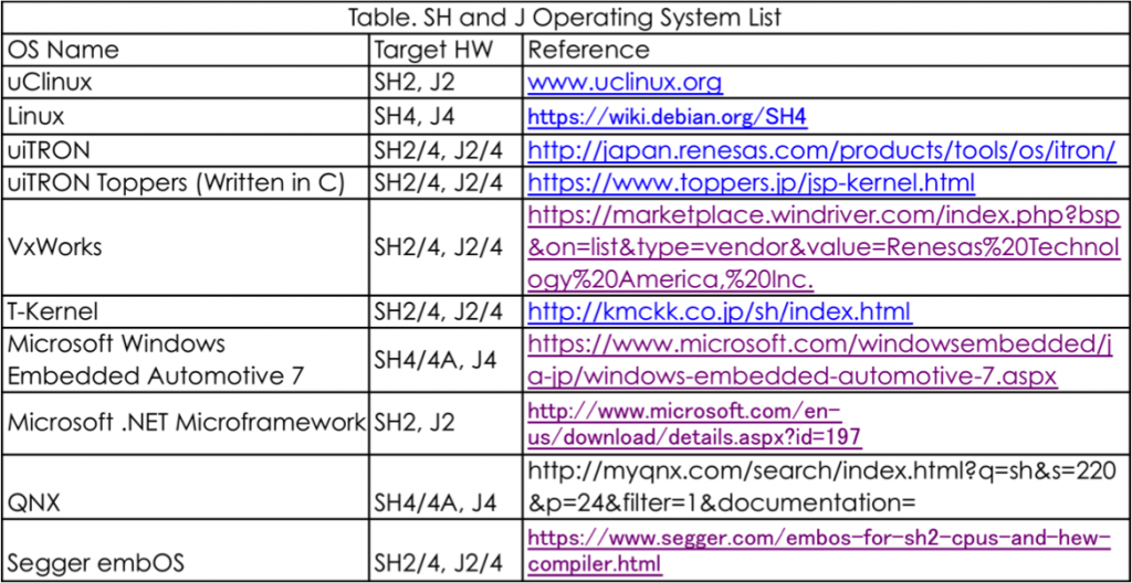

    If that is the case that would be pretty amazing! I also seen something on that page called Segger embOS which is for the SH2/4 chipsets.
    Would be interesting to learn a bit more about what that is.
  9. Zeigren
    Zeigren Spirited Member
    Jan 19, 2014
    191
    124
    I believe he was talking about buying similar SH4 CPUs off of Aliexpress and the like.
    Even if these do make it to silicon it is unlikely to be in a similar package, or to be a complete drop in replacement. However they are available as a core, so it can be ran on an FPGA. So in order to use this in a Dreamcast an all new motherboard would need to be made based around an FPGA. Which would be fun but quite an undertaking.
    Another thing to point out is that an increased clock speed can only do so much, you're just moving the bottleneck from the CPU to some other portion of the system. The best way to do this would be to reverse engineer both the HOLLY and AICA and recreate those in a FPGA or two, then make a new motherboard around all three. That way it can be made using entirely new parts, it could be significantly faster, and you could do things like add more RAM or other shenanigans.
    Segger embOS is a real time operating system, it basically lets you program for a particular architecture without having to do "bare metal" programming but is geared for more time critical applications than say full blown Linux. Like in the case of deploying an airbag which needs to happen within the small time frame between when the collision occurs and before your face smashes into the steering wheel.
