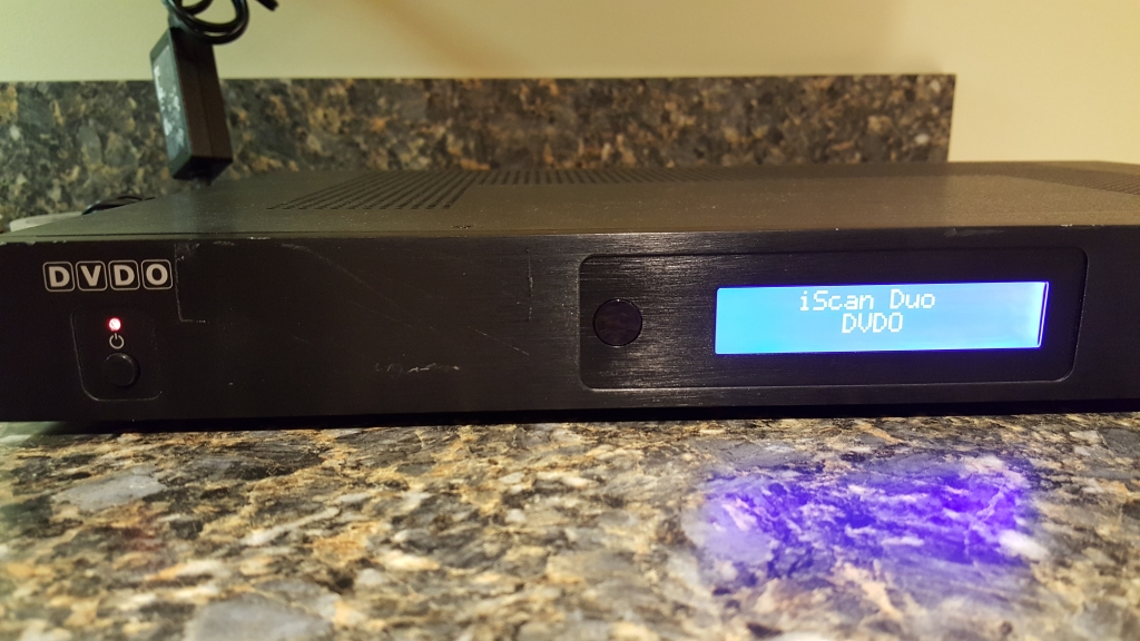

    I just bought a used DVDO iScan Duo on eBay and it arrived Monday. I planned on connecting 2 consoles that use component (PS2 and my CMVS) and all of my HDMI modded consoles to it for convenience. Tried it out for the first time yesterday and I can't seem to get it to work. It has a red light and just says "iScan Duo DVDO" on the front screen. None of the buttons on the front of the device do anything. It didn't come with a remote so I programmed my Logitech Harmony remote for the DVDO iScan Duo and that doesn't seem to do anything either. I connected several devices to multiple HDMI ports and nothing. I found online how to do a factory reset by pressing the power, menu, and exit buttons at the same time for several seconds. That did kick it into factory reset but it freezes and says:
    Factory default
    Please wait...|
    Does anyone have any experience with the DVDO iScan Duo or any information that could help? I paid over $200 for it and if I can't get it to work soon, I'm going to have to return it.
    Any help would be appreciated. Thanks.
  2. The Rook
    The Rook Member
    Jan 21, 2018
    This is all it does when I plug it in:

    So I've posted this question to several forums and some people over on shmups.system11.org helped me figure out that the power supply is 12V 3A and the DVDO iScan Duo requires 12V 5A. Talking with a guy from a local electronics store he explained that this could be the issue but he didn't have a 12V 5A power supply for me to test.
    I've been communicating with the seller and he confirmed the power supply is not original and is waiting for me to purchase a proper power supply and get back to him.
