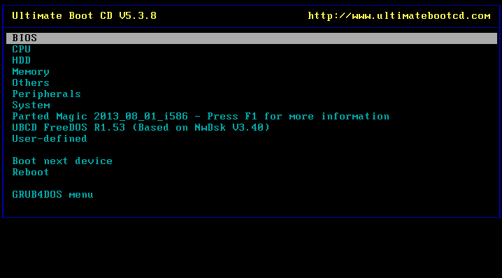

    Ultimate Boot CD
    You could use my favorite portable diagnostic suite to test out the drive, but it'll probably just affirm your suspicions.
    Go to: http://www.ultimatebootcd.com/
    Just download and burn the ISO, it's a pre-done bootable suite of apps for diagnosing just about any hardware problem.
    Here's the first screen you see:
    From here you'll hit F2 to enter the HDD Tools menu.
    SPACE will take you to the next page and ESC will take you to the previous page.
    On the second page there will be the Hitachi/IBM Drive Fitness Test which is an excellent HDD tester no matter what brand you own, also on that same page (or maybe the next) will be Seagates OWN HDD tester.
