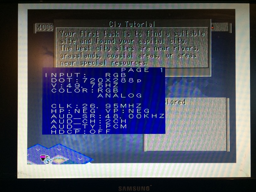

    Thanks for the reply. I know on the SNES and MegaDrive it's just on the top and bottom, however the Playstation does it all the way around as shown in the pic below:
    I inverted the output of Civ II to make it show the borders.

    That's odd. Might just be that specific game, saving resources by not drawing in the overscan areas...? Do others behave the same?
    edit: I'm too lazy to plug in my PS1, but I went on youtube and looked at some random games. FIFA 98, Urban Chaos and Ridge Racer showed the same border, G-Police and Tomb Raider seemed fine. I obviously don't know what versions (PAL/NTSC) I was watching though... Anyways, doesn't seem to be Civ2's fault. Maybe it's the PS1 adding those borders in hardware when outputting an internal 640px wide framebuffer to a 720px signal...
