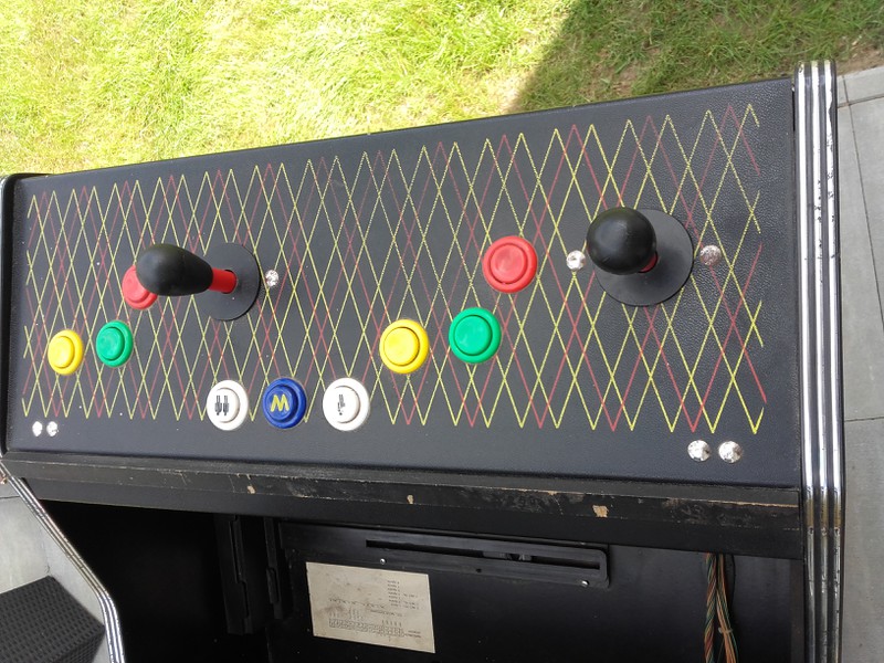

    I have this cabinet. The screen and the power supply are dead and I thought of making my own MAME machine with it, using a Linux and/or Windows version of "Groovy arcade" for example. (Except someone would recommend me another MAME version, because I want to go with "xi mo" or "mini pac") :
    I found the cheaper xi mo :
    http://www.xin-mo.com/
    And the pricier mini pac :
    https://www.ultimarc.com/minipac.html
    Anyone of you uses these or can share his experience with one of these ?
    Maybe got another advice ?
    The machine I have is this one :
    http://assemblergames.com/l/threads/need-help-identifying-a-arcade-pcb-board.62495/
    Id say I go for the "cheap" xi mo 1st, if not adviced otherwise.
    It should work fine with MAME live CDs ?
    And as it smells of smoke, where would one buy "new buttons and joysticks" that would fit to this machine except on ebay ?

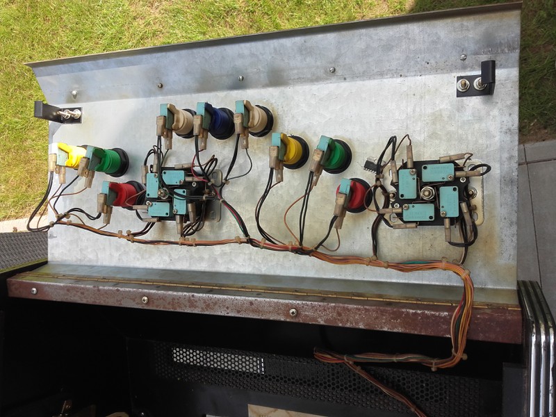

    Just throwing this out there, but I used one those: https://www.ultimarc.com/ipac1.html
    With my senior project to design a drone controller via WiFi and it worked very well. The software is straight forward and you can change the key inputs to anything you want. Plus, all of those buttons you have pictured are just +5v/Ground cables.
    If you use the I-pac, then no special software would be required as it just send keyboard keys as input. We used a Raspberry Pi and it worked very well. You could also use Retro-Pi to power the cabinet.

    Yep, the I-Pac gets recommended a lot. Another way would be to get some random cheap USB controller (or two) and connect the arcade hardware to the contact pads on the controller. That's what I'm using for my current setup. It may look a bit ghetto inside the case but works perfectly.
    Buttons/sticks can be had on lots of chinese sites, e.g. on AliExpress - They're available separately, and also in kit form, often with an I-Pac-like device included.
