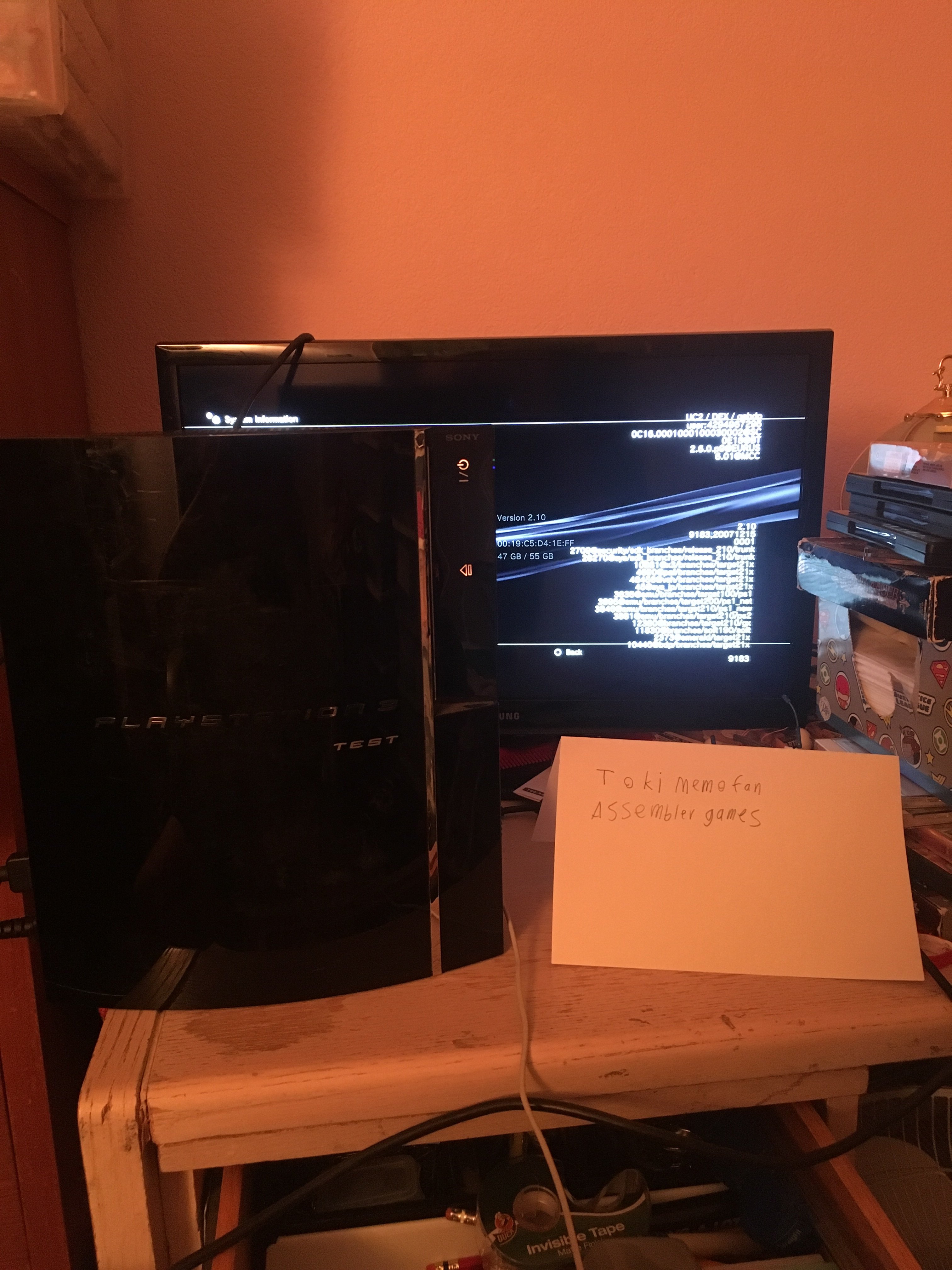

    What’s this worth

    Mmm a blueray player only demo system, this was sold to companies for testing BD films. I guess 200-300 $ as Decha00a systems, this would be a little more rare

    More like a LOT more rare and almost completely useless.

    this is a particular motherboard and model configuration we havent seen yet which is interesting in itself
    it is rare, but its useless in the long run
    its hard to gauge a price on the item because its only useful to a small handful of people

    The system itself is rare, but somewhat useless, you might find a buyer for €300 among collectors, while it should sell for more, I don't see anyone going to pay more than €300 for one of these.

    It isn’t useless. I have successfully converted it to a fully functional machine patching the NAND with Progskeet.

    you wouldn't know the original target id/idps by any chance?

    The Target ID was 82 but was still not possible to install any DEX PUP. Stock FW was 2.41. ros1 was empty, so I think this system was never updated.
    I have already noted it in 2016 at https://www.psdevwiki.com/ps3/Talk:IDPS
    There is also an AV Tool listed as ID 80, but this wasn't true for my unit. The second entry for DECHSA00A/J is my entry.
    BTW: I still have the original dump from Progskeet.

    I would be interested in the dump if you could share it, the factory ros is probably interesting to look at.
