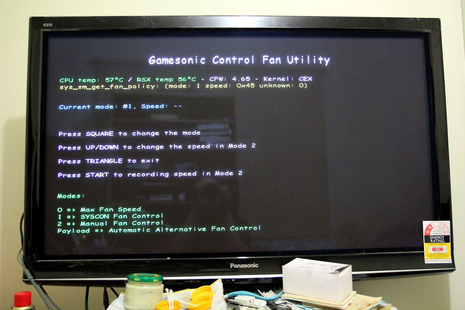

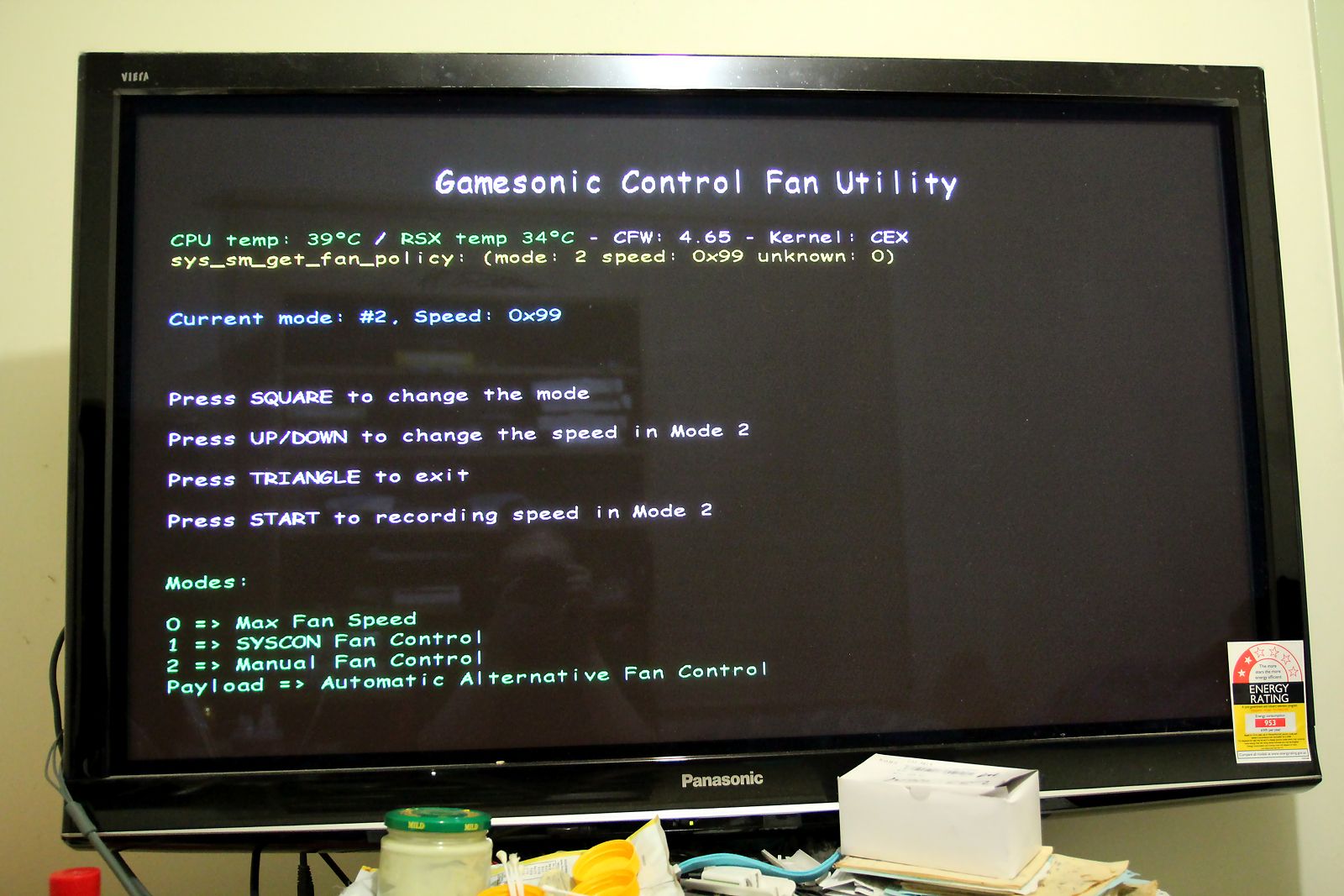

    you could do something similar to what i am doing , Fan mod that is externally powered and i have flashed CFW not only for games but i can control the stock Fan speed of the internal Fan.

    When I did one I used a 250k pot and it works just fine,did you have the fan running on 12v the whole time.
    And FireAza,what FW are you running,if you could install custom firmware you could control the fan via software.

    Latest version (4.3 I think). But controlling the fan seems unnecessary, it seems to be doing it's job just fine! :D I'm just looking to patch up the flaws in Sony's design of the PS3 that eventually kills it. Using lead-free solder was the biggest mistake, but it seems like the thermal paste they used was poor quality too. The fan working harder would also help, but increasing the amount of heat being delivered to the fan would also accomplish a similar goal.
