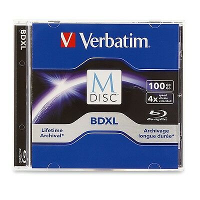

    Verbatim Archival Discs are the best option, but very expensive in my opinion.

    I like how they're advertised with a lifetime of several hundred years but come with a limited warranty of only ten years... But in the end that's still a lot better than any normal CD/DVD, I guess.
