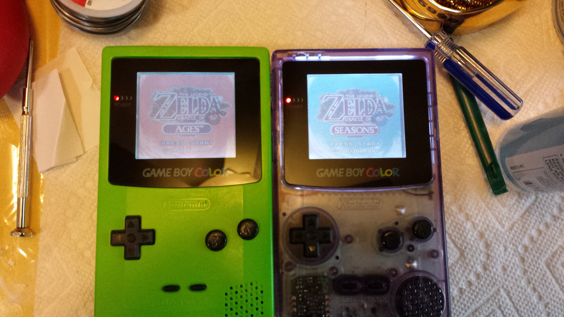

    Here are the two gameboy colors that I did with Osaka 7 loca and the front light kit. The one on the left looks a slight bit dimmer in this pic because it has old batteries in it, while the one on the right has a brand new pair of batteries. Both are perfectly playable at these light levels, though.
    This is a mod that should be approached with the right expectations-- first of all, that textured diffuser is very prone to picking up bits of dust during installation and getting it to be very clear is difficult. A piece of scotch tape seemed to be the best way to grab the dust, although unless you have a flawless kit and a perfectly sterile workspace it seems pretty likely that there will be specks on the screen when it's closed up. Honestly though, I don't notice the specs during gameplay and you will only see them during black screens.
    The keys to doing it right are to be patient enough to work any bubbles out, and to keep the screens and your work area as clean and dust-free as possible. Wear gloves when handling the screens if possible. I recommend keeping a AA battery holder handy so as to turn the light on and look for bubbles. Also, the Osaka 7 loca is reverseable. I had to re-do the Kiwi Green unit since I didn't properly clean the screen and got dust under the loca. With a little bit of fuss it peels off like a gummy gel, and you can clean it out of the "trenches" along the screen using a toothpick. I highly recommend the Osaka 7 in case you need a do-over, or if ultimately decide this mod isn't for you.
    It's a little more washed out than my GBA SP 001 screen, but it's a bit brighter and has a "cooler" hue to it, which depending on your preference may be more desirable. More importantly, I get to enjoy Gameboy Color games on a larger screen area with the original GBC form factor. Whether or not this mod is worth it boils down to how much you like the Gameboy Color itself.
    I haven't seen the SP frontlight mod to compare it with, but this mod is a fair bit easier to install, requires no modification of the GBC's housing, and doesn't require destroying an SP for parts. If you have a broken SP lying around and are handy with a hobby saw and dremel I'd say give that mod a shot, but I really like the results I got using the aftermarket kit and loca, and if I ever decide I want to do the SP light mod someday I can always remove the light kit and loca.
    It's a somewhat tricky mod to install but I think it was definitely worth it. I've played with the Kiwi Green unit for several hours and I am very happy with the end results. It's really given me a new love for my old GBC.
