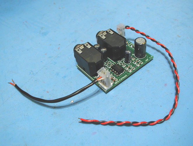

    I have seen a few different mods about for getting 'Stereo' audio from the front loading NES console, so include pots on the 2 audio channels, another just had 1 dial on the rear of the console and ive recently seen Low-Gains one http://www.youtube.com/watch?v=2vxjL6KTyUs that doesnt use any pots. So which is regarded to be the ideal one to use. Also do any of the NES/Famicon systems have stereo out of the box?

    But what about the mods where it just has a dial mounted on the outside of the NES case how does that work?...is it just a volume knob then?
    So you prefer to have a dual mono setup then by using a Y adapter for the audio RCA on the side of the NES?
    I guess Low-Gain's mod is the easiest one to do then http://lowgain-audio.com/NESmod.htm, it appears to amplify the audio aswell??
    EDIT: Just read the info on his site....
    "Pulse Channels ouput on Left
    Tri/Wave/Noise output on Right
    (all channels summed to mono if only LEFT output is in use)
    The output is boosted (fixed amount) to get you a bit more bang for your buck. This output amplifier also provides protection from reverse voltage spikes to your NES's main board.
