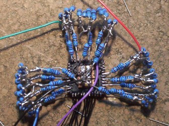

  6. Bad_Ad84
    1,309
    Or you can make your own. Its just a CPLD and some resistors.

    Hmm, seen it done without the board and... it doesnt look so good but i guess it works. Im thinking of maybe getting a prototype board made if its not too costly, just need a *Edit* gerber file and other files to get a board made.

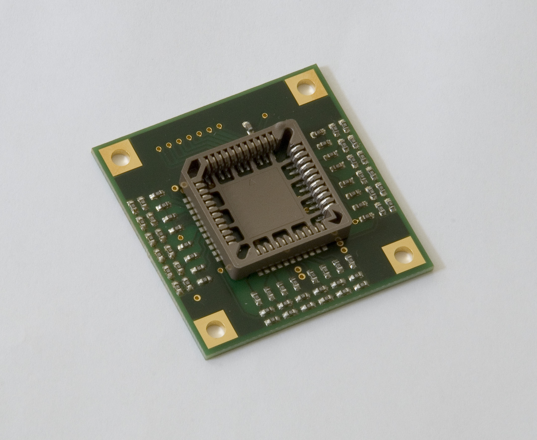

  12. angryswede
    angryswede Rising Member
    Feb 15, 2011
    57
    I had these made recently. PCB from PCB-pool (excellent quality), idea and code from Tim and designed & assembled by a local friend. I haven't had time to cross-check with the nfg one yet, but it's probably very similar in design. I've installed it in ten PAL units and it seems to be working fine.
