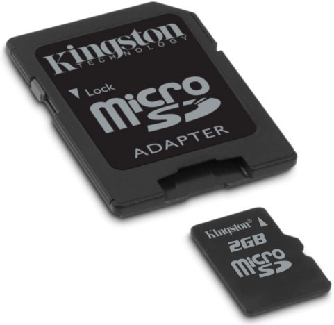

    Thank for the reply. Btw does a Sd Micro to SD adapter work on the Mega Everdrive?

    Well it does but can be picky. I have four adapters and three are el cheapo no name ones and they dont work all the time. Sometimes I have to pull out the card and re-insert them and it works but then it will stop working. Now I do have one that came with my class 1032gb microSD and that adapter has NEVER failed me so I stick to that. I think it is the build quality of the adapter not the EVERdrive itself. But yes they do work but the largest I have tried is a 32gb and it works fine. I normally use an 8gb as it fits all my ROMs and is fail proof so far. Krizz has totally made the best flash cart ever. It out performs all my others I have bought in the past hands down.

    atreyu187, I have a 2gig Micro SD card here. And all the GoodGEN roms takes about 1gig unzipped. So I guess you dont need more than 2gig. Also the Master System roms are very small.
    Yes but it still haven't figured out where to insert the Micro Sd card! Is it the same slot as the regualar SD card? If so there is no problem. I would like to see a photo of someone using a MICRO SD card on a Mega Everdrive. I just figured it would be tough to insert and remove a Micro SD card when you have a shell? So thats why i asked about the Sd adapter

    In that case, I use a Sandisk adapter on my Everdrive MD with my micro card. Probably a Chinese clone but I've never had a problem with it.

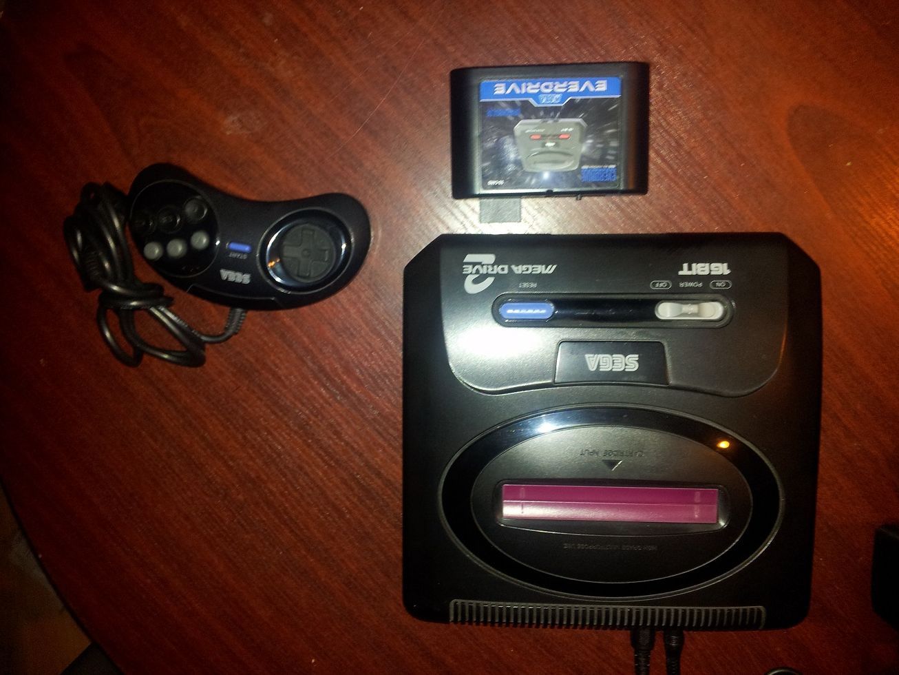

    My 2 cents is that if anyone is like me and scared about cutting shells and such, just order a cart with shell.
    The shell supplied by Dragonbox shop with mega everdrive readily installed in it was very nice indeed:
    Actually I´m looking to get a 60Hz genesis instead of this md but it has worked ok for initial testing of mega everdrive :)
