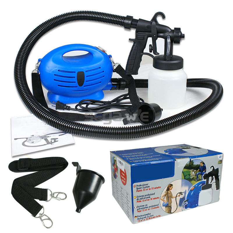

    Ditch the spray cans and go for a paint gun.. You can even get electric ones :D

    Paint... gun? I don't think I've ever heard of one of those.
    Unless you mean an airbrush, in which case, those can be really expensive, and they've got a steep learning curve. Once you can use them well, though, the end results are seriously impressive.
    That being said, for something this size, I'd argue that spray paint is more efficient. It'll cover it quicker and cost less. Even without the initial price of an airbrush + compressor, you're still looking at paints for airbrushing (some airbrushes even use special paints, or at least special bottles, although I suggest you get a top-loading one that doesn't require this), and those are all small pots that you'll need to buy multiples of.
    Besides, airbrushing is better for smaller, more precise details. If you're doing models, then I'd recommend one, but only for game consoles with simple shades of colour? Probably not worth it.

    Spray paint guns have been around for a long time :)
    http://www.ebay.com.au/itm/Electric...13?pt=LH_DefaultDomain_15&hash=item19f87172c1
    Air brush is only good for small stuff but a spray gun can cover a large or small area, just adjust the spray pattern and flow rate..
    The most common area these are used is in car body painting but as I said you can easily paint smaller stuff like a console with this, they provide a MUCH better result as it's more controlled.. Also cheaper than buying cans because you can use paint from a tin :)
