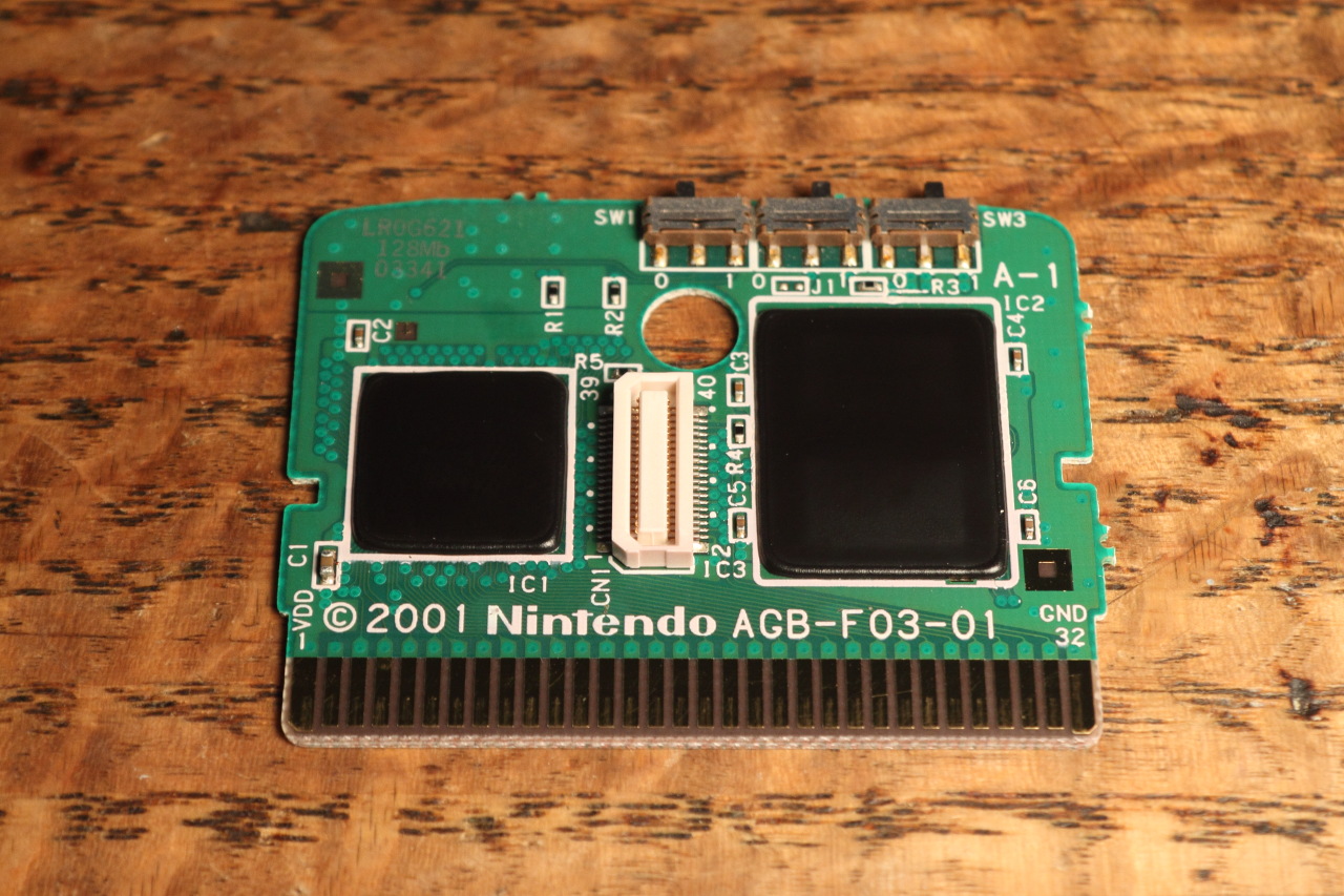

    I recently ended up with a Gameboy Advance dev cartridge with a very unfinished version of Catwoman on it. I'm wondering how best to go about dumping it. And once I have a copy of its current contents, would it be possible to reflash this card with something more interesting?
    Note that it's currently set to 128mbit. Can anyone read the Japanese below?

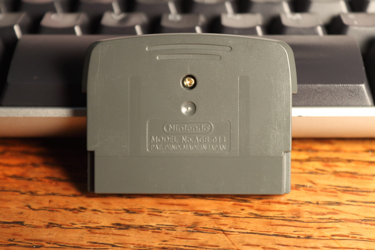

    Part number AGB-013 is a GBA game that features the tilt sensor. I guess they reused the case plastic.
    I suspect I'd need to plug a special cable into that white port to reprogram the card.

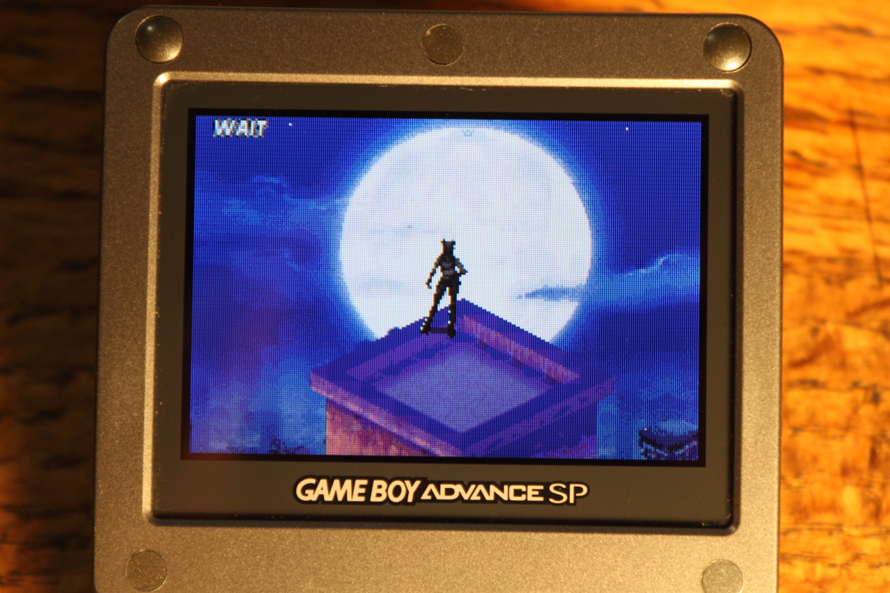

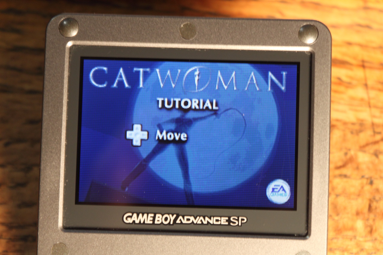

    And here we are booted up.
    The game is very unfinished. No intros, no sound, etc.
    It says WAIT in the top corner because that's what the character is doing. It changes to say RUN, JMP, FALL, etc.

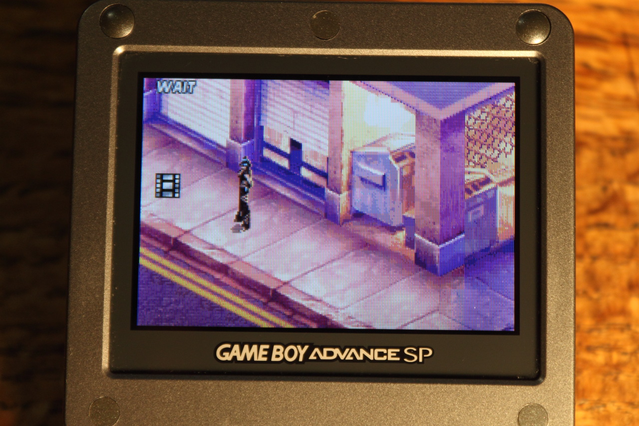

    And all over the place are little icons like this, which seem to suggest the developers planned to put something there later. I've never played the finished game so I don't know.

    You'd need an official programmer which no-one seems to have, or a modified MBv2 cable which I've asked for a lot of times and no-one has.

  15. cypherpunk
    cypherpunk Active Member
    Jan 2, 2012
    43
    I will translate this for you, but it's a lot less profound then you think. ;-)
    Japanese:
    AGBカートリッジ 128MフラッシュS
    ディップスイッチの設定
    SW3はライトプロテクト用切替えスイッチです。ライターでの書込み時のみOFF、それ意外はONにして使用してください。
    スライドスイッチの故障を防ぐ為、ピンセットなどで切替えてください。
    Translation:
    AGB Cartridge, 128M Flash S
    Dip switch settings
    SW3 is the write protection switch. Please only switch it to OFF for writing, otherwise keep it in the ON setting.  In order to prevent failures, please switch the slide switch using tweezers.
