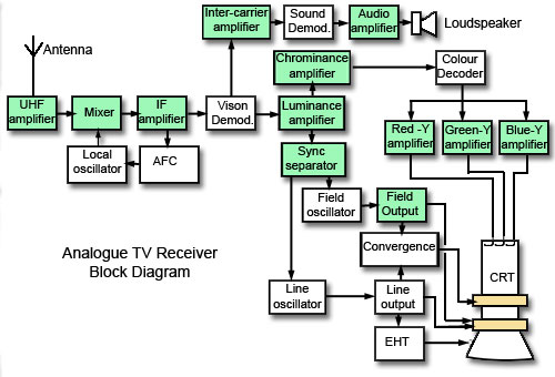

    That's something you should most definitely not say. CRT televisions all contained the same basic circuitry:
    (thanks to www.learnabout-electronics.org)
    The CRT still needs a high voltage, coming from the LOPT, regardless of whether the television is from 1950 or 2000. That's the same circuitry that will potentially KILL.
    Worse than that, your suggestion to just change trimmers to adjust the picture is not only just temporarily hiding the problem, but it most likely involves touching components on the neck board with the power on - THE VERY PLACE THAT CARRIES HIGH VOLTAGE!
    If you're getting problems with flickering lines of colour, it's an excess voltage in the tube. Basically an issue in the RGB circuitry. It could point to a gun being on the way out, or the tube itself. Either way, it's probably not worth repairing - if you can even get the part now. Certainly not a job for anyone other than a professional, anyway.
