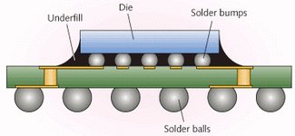

  10. LeHaM
    LeHaM Site Soldier
    May 5, 2013
    2,634
    292
    YLOD HAS SHIT ALL TO DO WITH THE BGA
    IT IS THE INTERCONNECT BETWEEN THE PROCESSOR DIE AND THE PCB SUBSTRATE!
