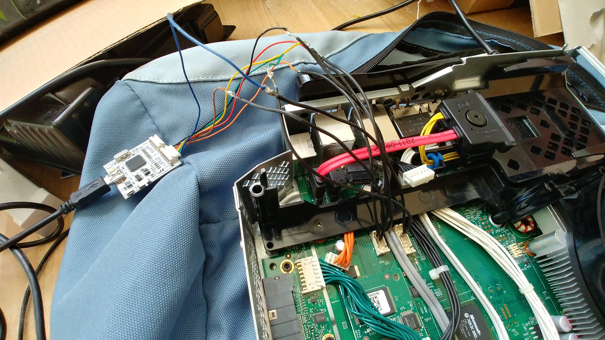

  20. BlastsMods
    BlastsMods Xbox Enthusiast
    Jun 21, 2015
    27
    I took a picture a few hours ago when I was flashing it, here
