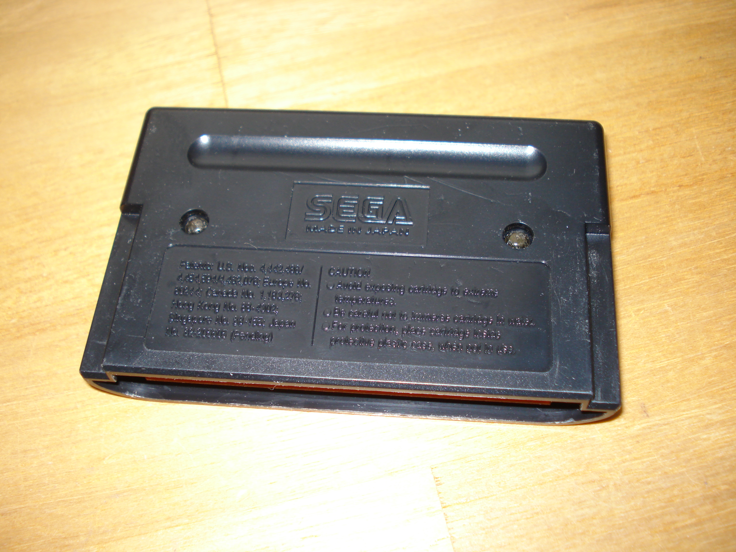

    So once in a blue moon i stumble uppon non working sega carts
    I have had many sega game carts but in almost 5 years of collecting I've come across 3 non working ones, If i would put the effort in also the cheap games I'm pretty sure i would have come across allot more
    I have this with
    toki going ape spit
    michael jackson's moon walker
    golden axe II
    It's not a super big deal came in big lots and not super valuable games in general but I'm pretty curious what the caus can be.
    With this golden axe II one for example I cannot see any flaw
    I have read that extreme heat could be a cause or if one soaks it in soda, than again for the last one I'm pretty sure the lable should be long gone.
    Does anyone know what the cause is or do sega carts fail at some point in time like the 3 mentioned above.
    I can't seem to find any damage, also if it happens with a pretty awesome game it would be quite a shame.
    I'm pretty interested if others have experienced it, I have had a close call with a turtles hyperstone heist but after some really good cleaning I got it to work, than again it was a heavily used ex rental so that one could be obvious.

    Cold solder joints are usually the 1st culprit. If its bad I've found the pads completely lifted off the board and separated from the trace (at the very worst only found 2 games like this; Mortal Kombat 3 and Dragon a Bruce Lee story). Try a full re-flow of the joints and test continuity from the top side of the ROM pins to the cart connector.
    If any scratches on the board inspect them too. Also not sure if the capacitor on the board may need a switch, but doesn't hurt to try.

    I would also check the vias. Fixed a friends Grind Stomer once where this was the issue.

    Also dead rom chip. Could pull it out and verify with a universal programmer

    No signs of life at all, no sound or picture absolutely nothing wich is my description of a game being dead.
    System plays all games fine even another copy of golden axe II so I highly doubt that would be the issue. Could test it on one of my other consoles but I highly doubt this would be the solution since other games with this issue did not work on other systems either

    Yes, I've had dead carts. Many people here have had dead rom chips.
    Dead rom chip in a cart is no different to a dead rom chip in an arcade board. The reason games fail less is just because arcade boards have more things to go wrong and therefore fail more often. But their roms and eproms are often a source of the issue.
    Ive had mvs carts with bad roms too, its all the same.
    It just seems like you dont want to listen that this happens and make up your own reasoning. Rather than listen to a person who repairs things for a living and repairs gaming stuff as a hobby and side business.
    Also remember, if the rom has corruption in sprite areas etc, the game will probably still play ok, just have corrupt graphics you may not even notice.

    When I am using arcade PCB repair as an example, I am specifically talking about when a rom fails. Not the PCB itself or anything else on the board or corrosion or anything else.
    You still get more rom failures on an arcade PCB because there are more of them on a PCB vs a cart. If an arcade pcb has 10 roms (often more) it has 10x chances of a faulty rom being an issue. Asking why carts dont fail as much as arcade pcbs (with rom failures) isnt taking this into account.
    Nothing is going to speed up or slow down the issue. Enjoy your stuff, fix it when it breaks.
    Seeing as you want some sort of reason:
    Bit rot (eproms, flash, OTP chips that look like maskroms).
    Manufacturing design choices (look at all the fujitsu logic chips dying)

    I had once a Sonic 1 cart that was looking like new. Like Bad_Ad84 said, it's bit rot and I have read somewhere that some megadrive games verify the checksum before starting.

    +1 for dead ROM chips. Not that long ago I got a copy of Quackshot for the Mega Drive, which even after all the cleaning in the world only gave a black screen.
    Desoldered and dumped the chip, and sure enough, it was faulty and had bad blocks of data.
