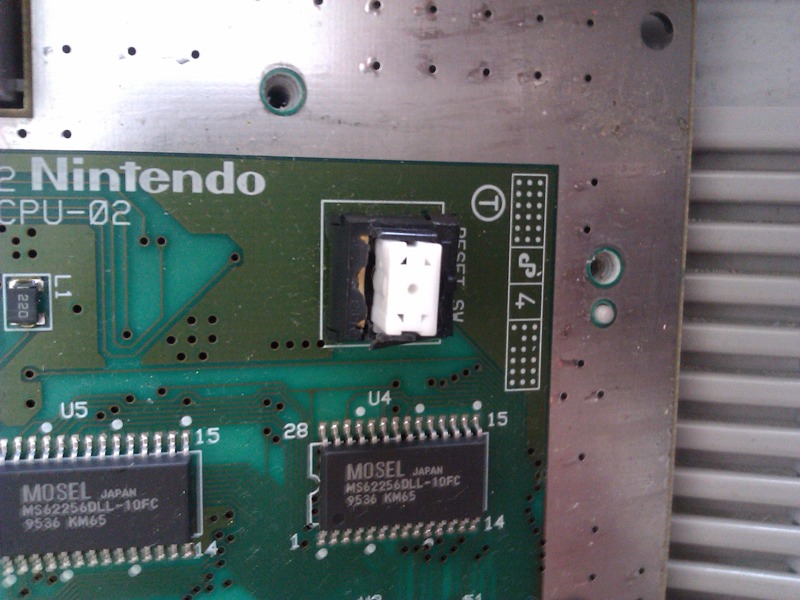

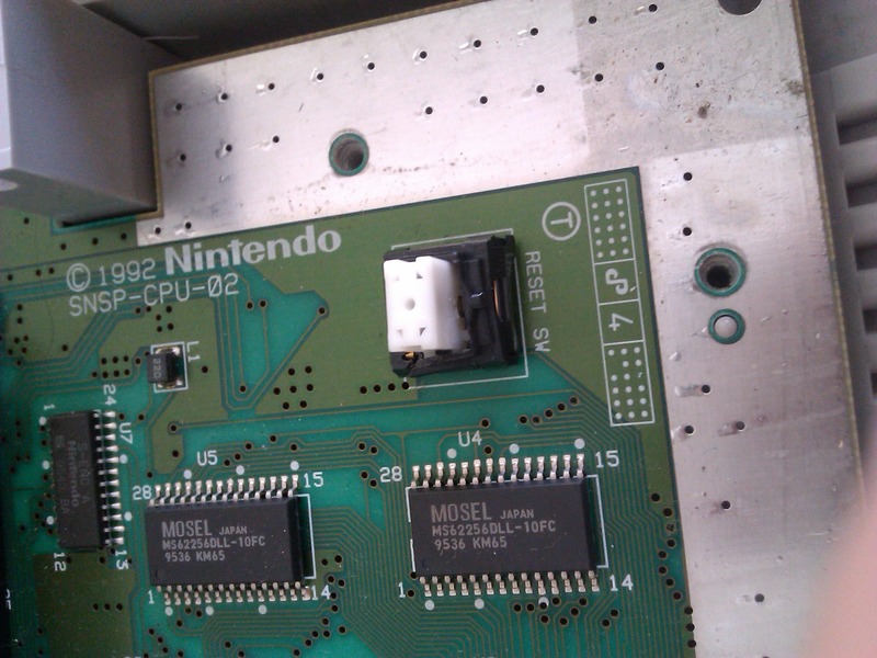

    hi,
    I have this SNES with a damaged reset button. Probably the console has fallen to the floor causing the damage. Now I have this switch totally broken, I can barely push back the spring, maybe I can try to fix it with a glue but I would replace it entirely.
    Is this a standard switch? Can I buy a spare one somewhere?
    Here the picture of an intact switch.
    many thanks

    Looks alot like the ones found on N64 mainboards. Maybe buy one cheap and salvage the part.
  7. retro
    You're not going to get internal parts from Nintendo. That's for replacement AC adapters and such.
    It'll be a fairly standard PCB mount push switch, probably SPST. The issue you might have is whether the button needs to fit into anything in the lid. Your best bet would be to desolder and strip it, see if you can repair it and, if not, replace it. You might find using one from a dead console (plenty of people will have one, no doubt) your easiest bet... or measure it up once it's out and check the distributors on my suppliers list sticky.

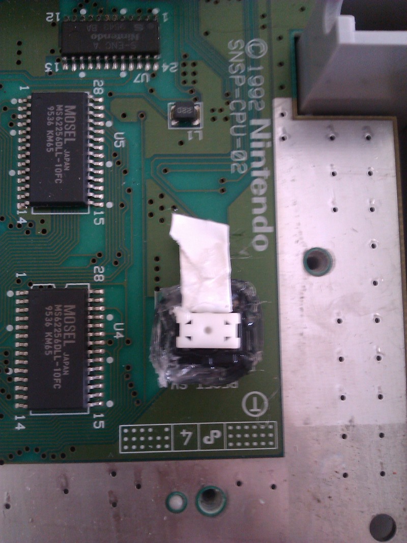

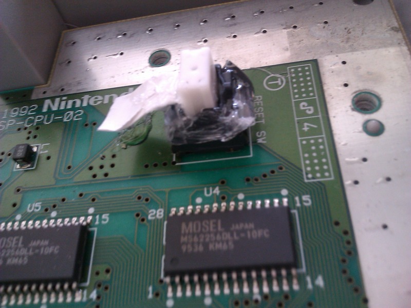

    I've fixed a bit, now I can use the button but I would still replace it. I'm looking for a dead console/spare parts in my country and It seems I've already found one!
    [HR][/HR]The recomposed switch
    You can see the copper, that piece of plastic is gone.
    A piece of paper and hot glue.
