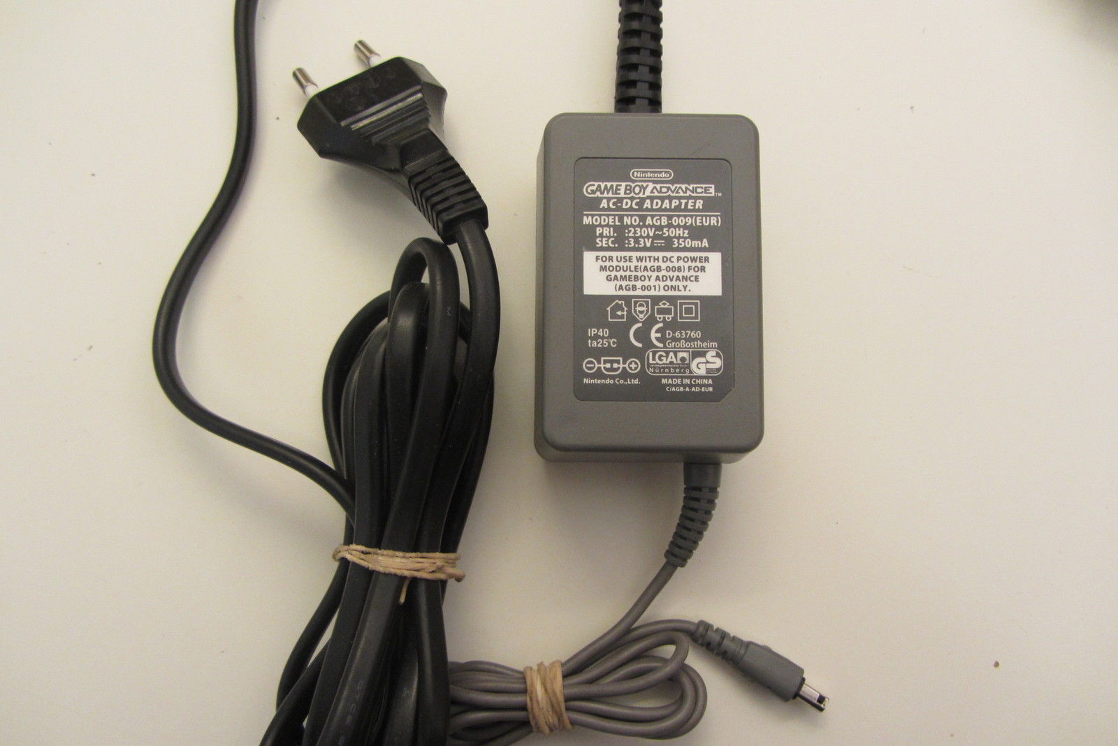

    Can someone help me identify those components:
    https://s23.postimg.org/6bbcqyqh7/piv_RQz_S.jpg (unidentified components)
    http://i.imgur.com/pivRQzS.jpg (original picture)
    That adapter named DC Power Module (AGB-008) comes with an AC Adapter (AGB-009) that have the specification DC3.3V 350mA. http://i.ebayimg.com/images/g/PTsAAOSwWnFV8~if/s-l1600.jpg
    Does someone have the diagram/schematic for that adapter or if someone have it can open it and make some pictures?
    Thanks!
    P.S.
    A friend of mine told me that components could be a smd diode (to step-down the voltage) and a smd coil (for interference). Sadly I don't have another picture with the other side to see if they are more components there...

    If I only buy the AC Adapter (AGB-009) and then wired it directly to the - + of the GBA, the console will work or will not work? As you can see in the picture the AC Adapter have DC 3.3V 350mA.
    Thanks!
  7. Lum
    Lum Officer at Arms
    Sep 30, 2010
    3,233
    It should work.
