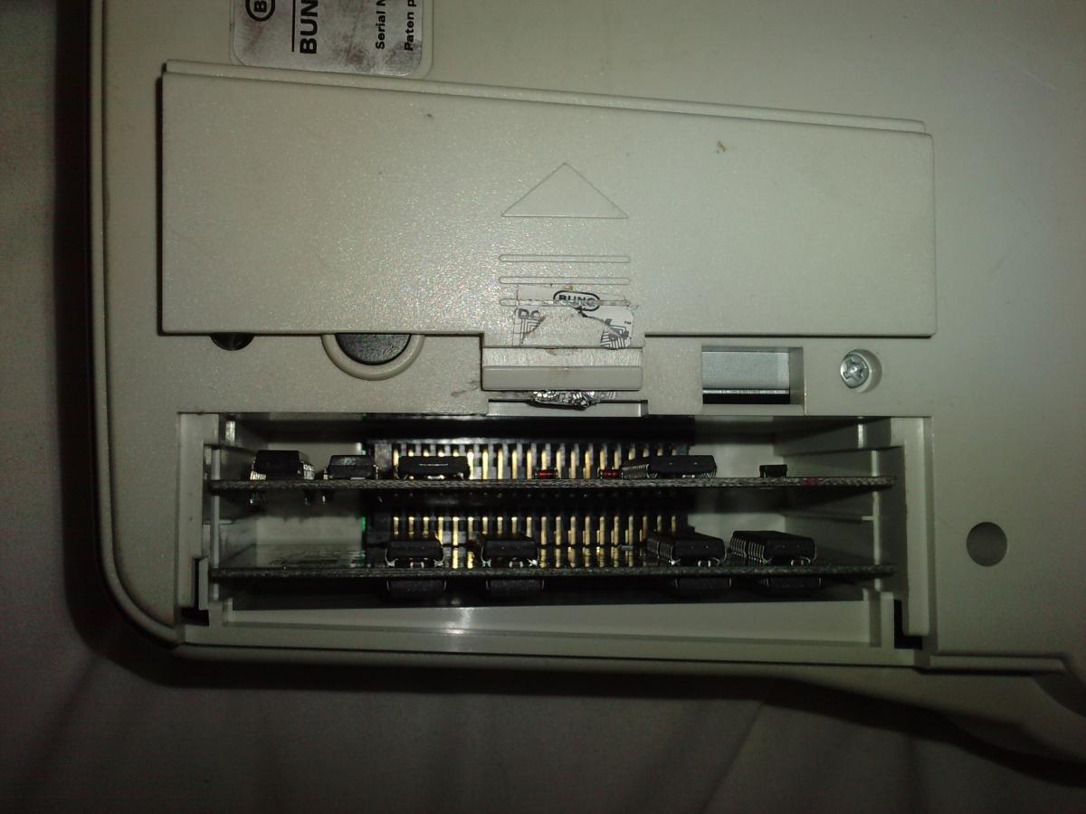

  8. Jackhammer
    Jackhammer Peppy Member
    Jul 14, 2008
    358
    59
    Turn the V64 upside down. There's a cover, slide it off. There's two memory slots. You need two sticks of memory for 256m games. V64's shipped with 128m iirc.
    Edit: added pic of my V64 with 256M.
  9. Mysticmaus
    Mysticmaus Active Member
    Nov 20, 2009
    47
    Hmm , seems that I only have 128 M after removing that cover , that explains it ...MEH.
