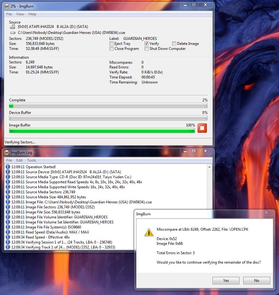

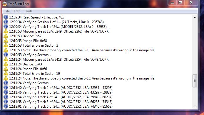

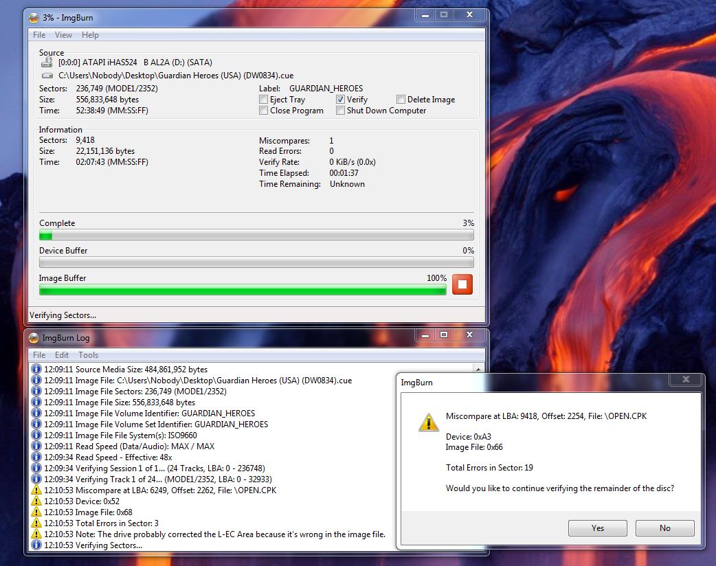

    I tried burning a Darkwater release of Guardian Heros with ImgBurn and got some errors. I use Taiyo Yuden CDR's and burned at the slowest speed, but when it verified the disc I got some errors. I have attached some pics. saturn fail.JPG 2.JPG 3.JPG

    You were told in the other thread that downloaded image files will in all likelihood be "faulty". It states right there in the log that the layered error correction was wrong in the image file and your drive tried to correct it.
    You could try using another drive (do Saturn games need subchannel data? I can't remember them doing so) or another burning app. Ultimately, though, buy the game if you want it that badly.

    I got it figured out. My images are not "faulty"! They are perfectly fine, I got my image from a respectable source. Not every downloaded image is faulty.
    This is the way the images were ripped: Mode1, RAW. Imgburn author stated in his forum that his software doesn't write in RAW mode, hence the reason I got errors(game would still play though). So I checked the game image CRC and it matched. I also checked with CDMage and it found no errors.
    I ended up burning with Disc Juggler using the proper settings and it burned perfectly no errors. I have done a couple of games this way and they work. They also verify good with ImgBurn.
