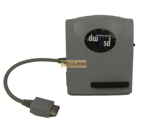

    Does anyone have a rom backup of PSXAmp?
    I've flashed it with Caetla 0.33 (newer version doesn't work on this cart) IN AR MODE and I've lost MP3 player functionality, after switching to MP3 MODE only [START] text appear (just like when booting CD in AR/Caetla).
