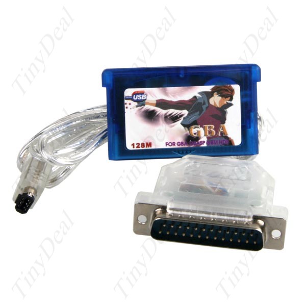

    I bought a long time ago a firelinker from aliexpress (pictured here).
    I was able to burn a Golden Sun rom, but I don't remember which programs I used, and if I used my F2A usb cable or the parallel cable it came with.
    I would like to use it again; the game save I made was still here and working; I erased the linker with gbaldr but when I tried to burn the rom there was a write error near the end, and even if I applied the SRAM patch with GBATA or FAT v8 I can't save. Sometimes there is an error at the beginning of the save, sometimes at the end, sometimes I can save but the game complains the save is corrupted...
    But gbaldr seems to be made for the M6MGD137 flash memory + a 256KB SRAM, while I have a M6MGJ927Y66DFP with a 128KB SRAM (TC55V1001).

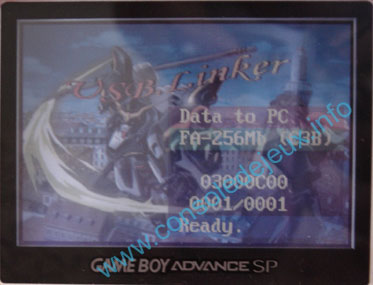

    I'm using Linux but I have a WinXP virtual machine: F2AUSBWRITER v1.02a disconnects the F2A USB cable when I click on the "Link F2A"; F2APowerWriter v2.61 and Flash2Advance USB Writer v1.1 show a screen like this on my GBA, but they don't recognise the card afterwards.
