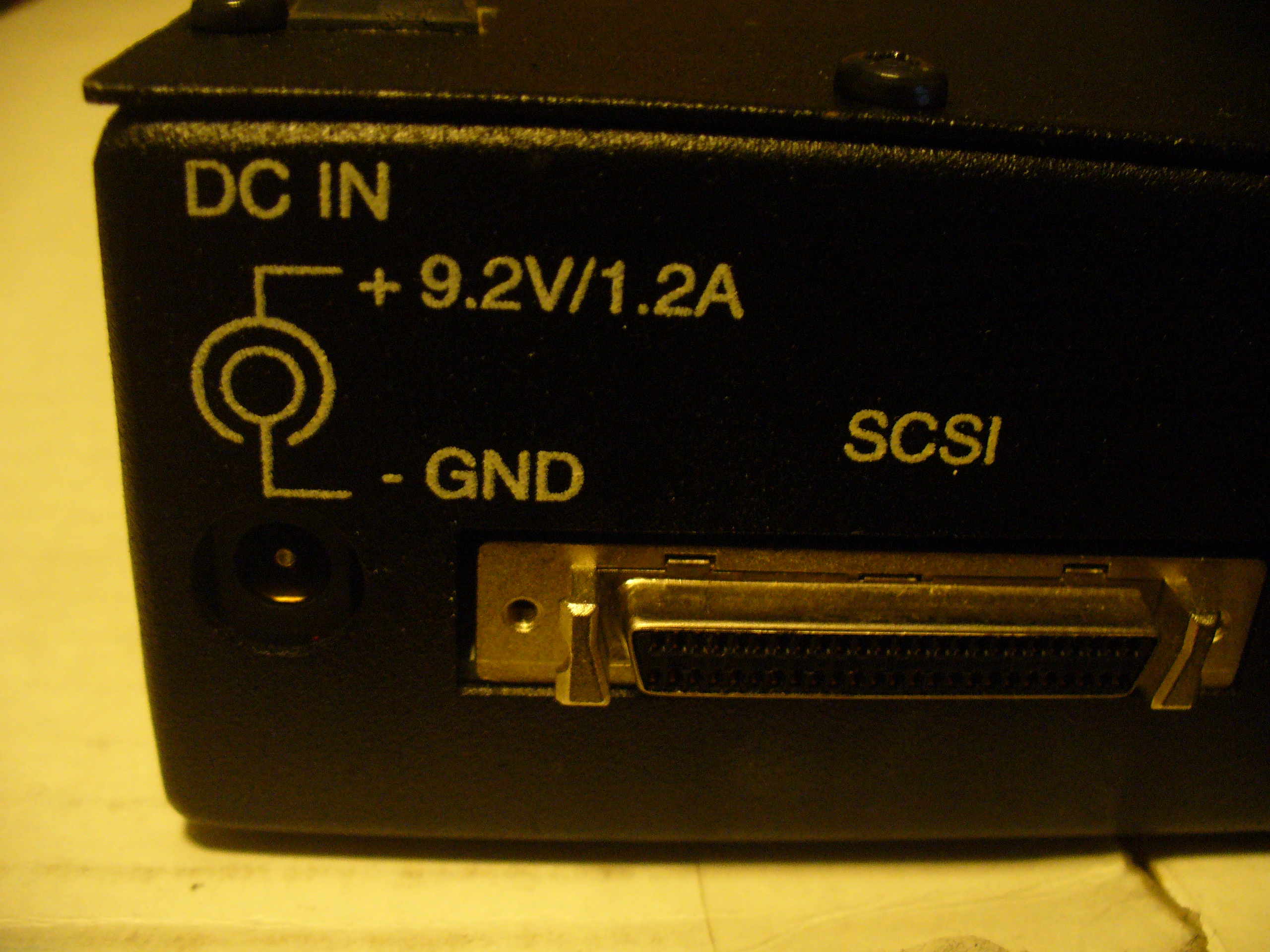

    I just got a Saturn Cartdev Rev. B but it didn't come with a power supply. The other ones I've seen seem to come with a Mega Drive model 1 ac adapter? Would a US Sega Genesis model 1 ac adapter work? I don't have a Genesis ac adapter so I can't test. P1010039.JPG
  2. retro
    If it supplies 9-10v at at least 1.2A with a NEGATIVE centre, yes.

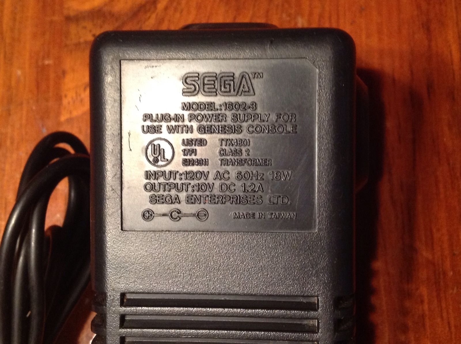

    So the Sega 1602-3 would work fine? It's 10V 1.2A
    I wasn't sure if going over 9.2V would be ok.

    I am using a model "1602-05" 240V -> 10V 1.2A and it works fine...
  5. retro
    Yes, I'm sure I've used one on mine, too.
