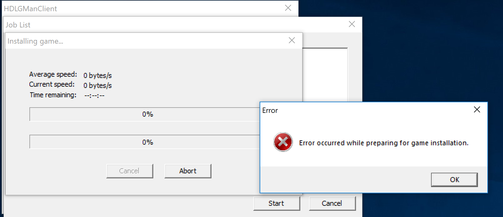

    Not really, but i got different results. Now, it doesnt take too long to give an error if something wrong happens at 99%, it is almost instantaneous. I left 4 games installing and i went to sleep, while i was in bed i heard a windows error sound, and i went to see what was it, and HDLGManClient had the top progress bar at 0% and the second at 25% with a error popup box saying something like this: "error preparing game for install"...
    It had 11 GB free, all 3 games i tried where below 3GB.
    AlGollan84 likes this.

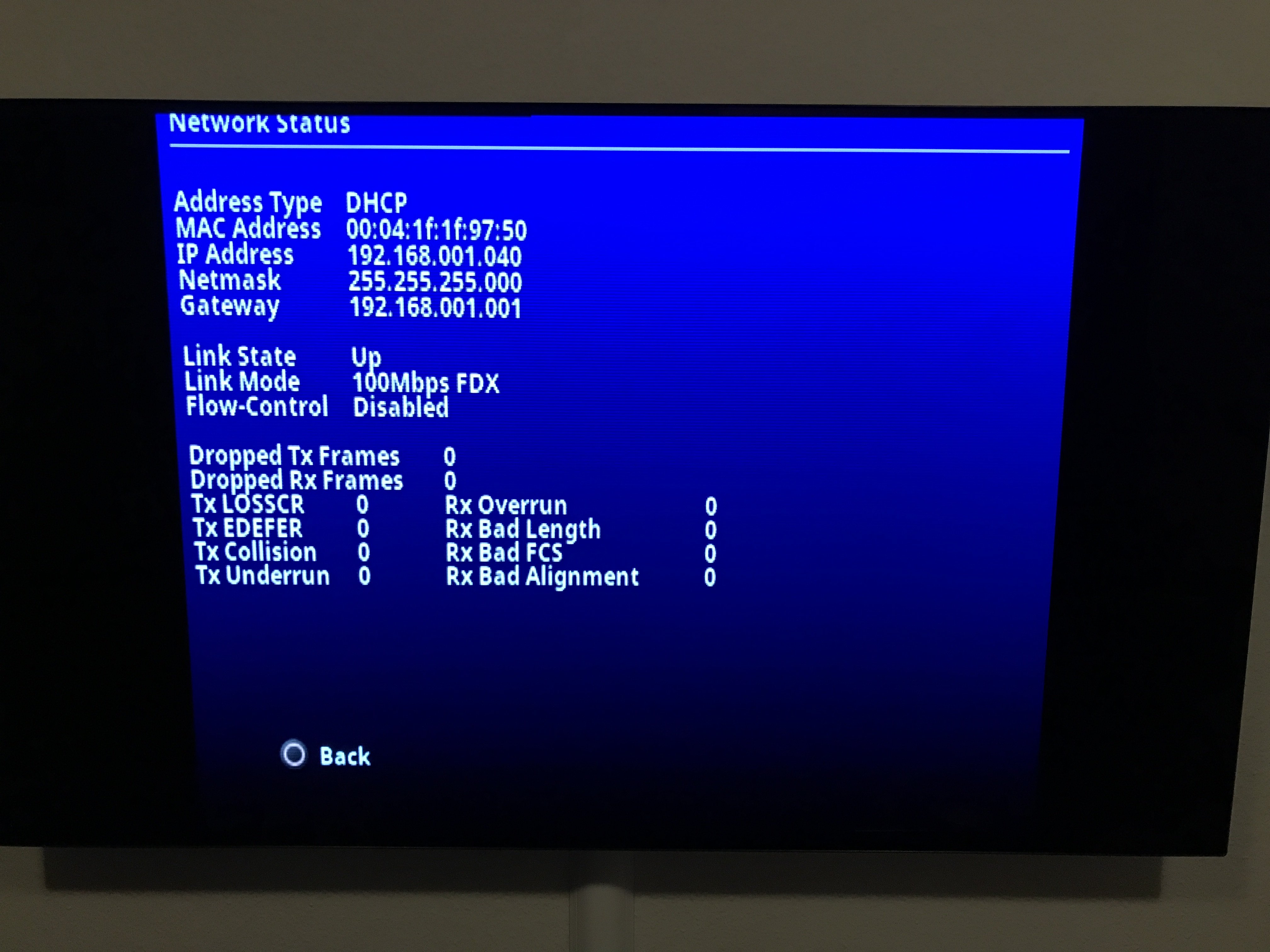

    I'm trying to install some 240p hex-edited titles to my HDD through this software, but I'm having little luck getting it to work.
    I can connect with my computer just fine and see whatever is currently installed (installing from original discs works on the PS2 works just fine of course), but every time I try to transfer to the PS2 I get the following error:
    I can't copy from the PS2 HDD to the PC either*.
    *This actually worked once, when I tried running the program under Wineskin in macOS, but the transfer to PS2 didn't work here either.
    Some info:
    PS2 is a 50004 FAT.
    I have a DMS4 pro modchip in my PS2, that I tried disabling too.
    HDD was formatted with uLaunchELF.
    The harddrive is a 2.5" 500GB (can't remember the brand), connected via a Sata to IDE adapter.
    The network adapter is orginal Sony.
    Computer is connected to my network via LAN.
    Any idea why this doesn't work? Could the harddrive be semi incompatible?
  9. sp193
    sp193 Site Soldier
    Mar 28, 2012
    2,217
    1,052
    Please access the network status screen (also accessible via network options, when not connected to the PC client) and check that flow control was negotiated for. If it was not negotiated for, then you have just joined the ranks of us who have this problem with 2010-ish equipment that cannot communicate properly with the PS2 from 1999. Especially if you have a Realtek.
    If not, then it could be just one of the various problems with network support in v0.817. I'll be trying to complete and make a new release soon.
    However, I cannot fix the lack of flow control with some network adaptors, since it has got to be agreed on and supported by both ends.
    Bearking and AlGollan84 like this.

    Right you are. No Flow-control :/

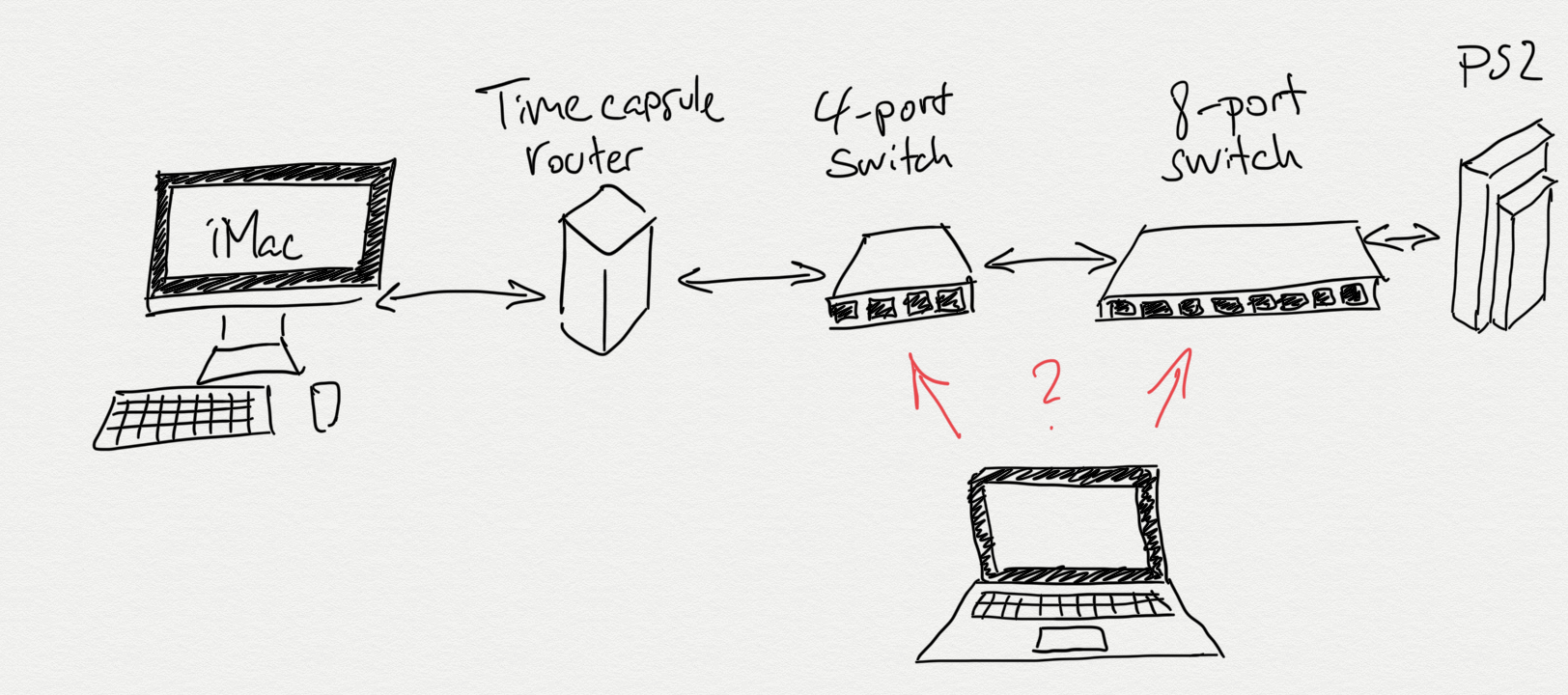

    Maybe if I got a USB to RJ45 adapter for my Laptop and tried that way, it would work better?
    This is basically how my network is set up. I would imagine the router being the problem.
    Can I expect it to work if I use a USB to RJ45 adapter and hook my Macbook up to either of the switches? Or would the router still cause trouble? Network isn't my strongest side :)
  11. uyjulian
    uyjulian Rising Member
    Jul 22, 2016
    54
    Just hook your laptop up directly; no need for switch or router.
  12. Bearking
    Bearking Konsolkongen
    Aug 2, 2010
    856
    100
    But then I would need to deal with crossover cables and whatnot, wouldn't I?
  13. uyjulian
    Jul 22, 2016
    54
    No, as Auto-MDI-X solves that problem.
    Bearking likes this.
  14. Bearking
    Aug 2, 2010
    856
    100
    Okay thank you :)
    I would still have to set the IP manually, right?
  15. uyjulian
    Jul 22, 2016
    54
  16. Bearking
    Aug 2, 2010
    856
    100
    Okay, been forever since I used anything but DHCP in my network. Just wanted to make sure :p
  17. sp193
    sp193 Site Soldier
    Mar 28, 2012
    2,217
    1,052
    What if you connected the PS2 to either the 4-port switch or the router?
  18. Bearking
    Aug 2, 2010
    856
    100
    The router really isn't an option as it's too far away. But I can try the 4-port switch :)
  19. Bearking
    Aug 2, 2010
    856
    100
    Using the 4 port switch helped a bit, as flow control now worked. I was able to transfer a single game fine, but once a game had been transferred the program refused to transfer more. So I had to restart the PS2 every time.
    I found an ethernet cable long enough to connect it directly to the router, and the computer itself, but it didn't make any difference.
    It was a bit annoying having to restart the console, but I didn't need to transfer much anyway, so it all worked out :)
