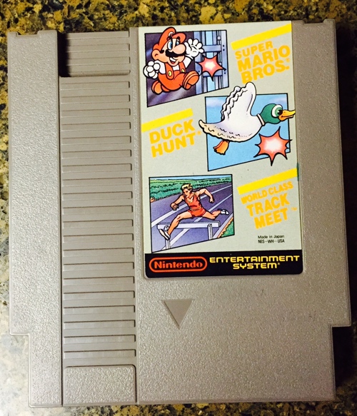

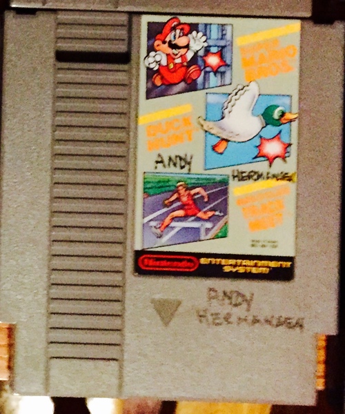

    If it's permanent marker I get a dry erase maker and rub it in till it's all wet then just wipe off. I know this is a huge heart attack in a box for most and I wouldn't give my 100% guarantee it will always work since i've only used it on a few cheaper nintendo carts and a dry erase board at work that a knucklehead used the wrong pen on.
    But here's what I just did..took me 5 minutes. Just have to go back and hit the few tiny spots still left. I didn't clean anything else on the cart Before.jpg after.jpg

    I tried this with 91% isapropyl alchohol and it didn't work very well. The marker did lighten but nowhere near as much as just using a erase marker. Maybe it's the type of Alchohol I used?
    I Like the silicone lube idea, going to try that next since I have to admit: making a bigger mess initially with the dry erase marker still makes me nervous when I look down and see MORE marker on the plastic before I wipe it off.
