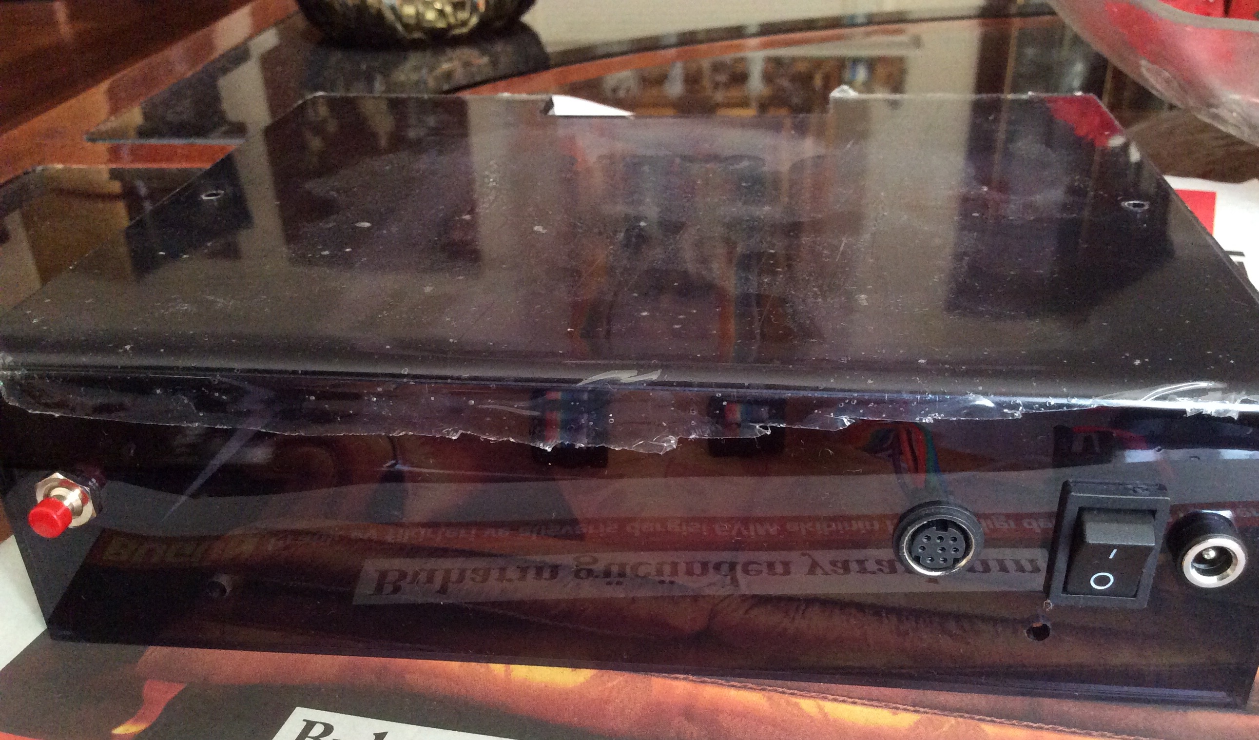

    Another masterpiece direct from our lab...
    Soon to be available for sale in limited quantity...

    80
    Can it still play Master System games?
  6. juji
    juji Active Member
    Dec 29, 2013
    25
    since it uses an original game gear board, it should play master system games with the adapter or with the gg everdrive.

    101
    Thanks. I haven't designed a circuit for the controller. There is no need for it since the Genesis controller uses the d-pad and B&C buttons directly just like an MS controller. It's done like a padhack. You don't need to use the rest of the buttons. Designing the case took too much time though, after many trials and errors. There are also some other drawbacks too.

    101
    RGB+S, however Tim's GGTV board supports SVideo and composite as well. So these can be added too.

    25
    start does work, but you have to rewire a donor pad for it.

    34
    When I consolized a Game Gear, I left it inside the Game Gear shell. I pulled the screen, transformer, used Tim's RGB board, and wired up a 9 pin controller port - re-purposing the select line pin as the start button. I then modified a controller to send the start button down the same pin.
    Although I am happy with the outcome, it would be nice to have a better solution for a case. The Japanese hobbyist that made a case that resembles a mini Sega Master System is often cited, but it wasn't mass produced.
