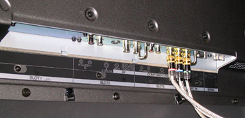

    Hmm... perhaps I misunderstand. On my plasma tv, I have a VGA input, a DVI input, and two "RGB" inputs - or at least, that is what I called them.
    Three component cables ... for instance, my cable box connects that way, as well as my DVD player.
    Is that not an RGB connector ? It's analog HDTV, basically ... in the case of the SNES, I assume it will be 480i, but still ...
    This is what I am talking about:
    http://www.plasmatvbuyingguide.com/plasmatvpics/panasonic/panasonic_plasma_tv_slots.jpg

    Component isn't RGB. American TVs don't, in general, do RGB. It is rare to find an input on a television for RGB that isn't a SCART socket (or the Japanese equivalent). I'm squinting to see what else you might mean. All I see is composite and component.
    You know what I'm going to say with regard to what kind of screen you need, so I won't say it. ;-)
