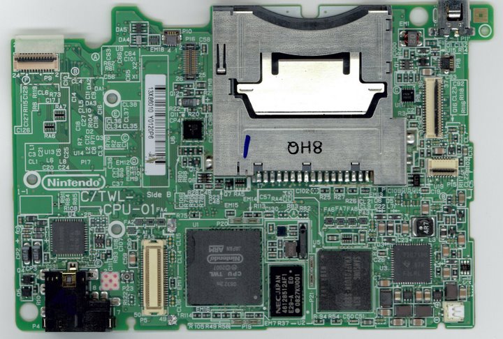

    the no battery part may be as simple as a jumper (as mentioned) or a diode.
    If you want pop up a high res pic of both sides of the mobo

    Not the same but in store unit Wii controllers, the + battery spring is gone and a wire is in it's place which then goes to the Wiimote's accesory port and it gets its power source from there. Could be something somewhat similar on the DSi to make it run off a power source other than the battery.

    I've only replaced the motherboard, not the the power board (the one with the fuse) or the wi-fi module. So for sure there's something different with the main motherboard.
    PS: I don't think it's a jumper because the console will not power on without a battery. It needs the battery and the charger at the same time.

    I made it work on a battery., but it doesn't charge. The orange led blinks like when the battery it's not connected.
    For anyone who wants to do that, here's a picture of a retail motherboard:
    https://dsibrew.org/w/images/d/d8/Twl_front.jpg
    Under the cart slot, on the right side you can see 3 components are missing. Remove those from the store/demo motherboard. They are labeled: C109, Q15 and Q14.
