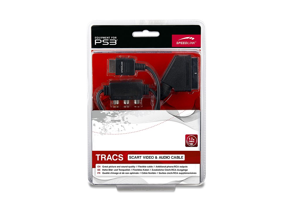

    Recently I bought a speedlink cable which was supposed to be rgb.
    When I power up my psx though I get composite video.
    Opening it I discoverer that there is no resistor between pin 8 and 16 , as well there is no cable soldered on pin8 either .
    If I just solder the resistor between those pins, will I get an rgb signal?
    Also, there is a jumper cable between pin 4 and 18.
    I'll post some photos tomorrow if asked to see the cable

  6. snobgamergr
    snobgamergr Spirited Member
    Aug 29, 2015
    Well I bought the cable from a store about two months ago,but it was yesterday when I first used it.
    When I took the photos, I discovered a grey cable on the +5v line (can't quite be seen on the pic though), so I guess I can make it display a true rgb signal.
    As you can see there is an RGB line, so I guess someone forgot to solder that resistor in place.
    Also I use it on a CRT TV, so there is no need for a converter/upscaler :)
    EDIT The the cable is this [​IMG]

    Bumping the thread just to tell you that I added the resistor and now I get a crystal clear rgb signal :cool:
