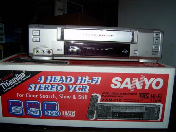

    This is the VCR model I've used for the last 9 years:
    I realize that post to AU is a pain, but, buying a high-quality NTSC VCR and a low cost capture card may be the best short term option, financially. It would cost you less than a third of the potential cost of the linked combo machine above.
    If you capture directly to your laptop (I do so with mine, and it is a relatively low power machine), you can convert the video to PAL, then burn to DVD, if you like.
    As for capture cards, as I have mentioned elsewhere, I can't recommend the Adaptec Gamebridge enough. Very inexpensive, and it does the job.
