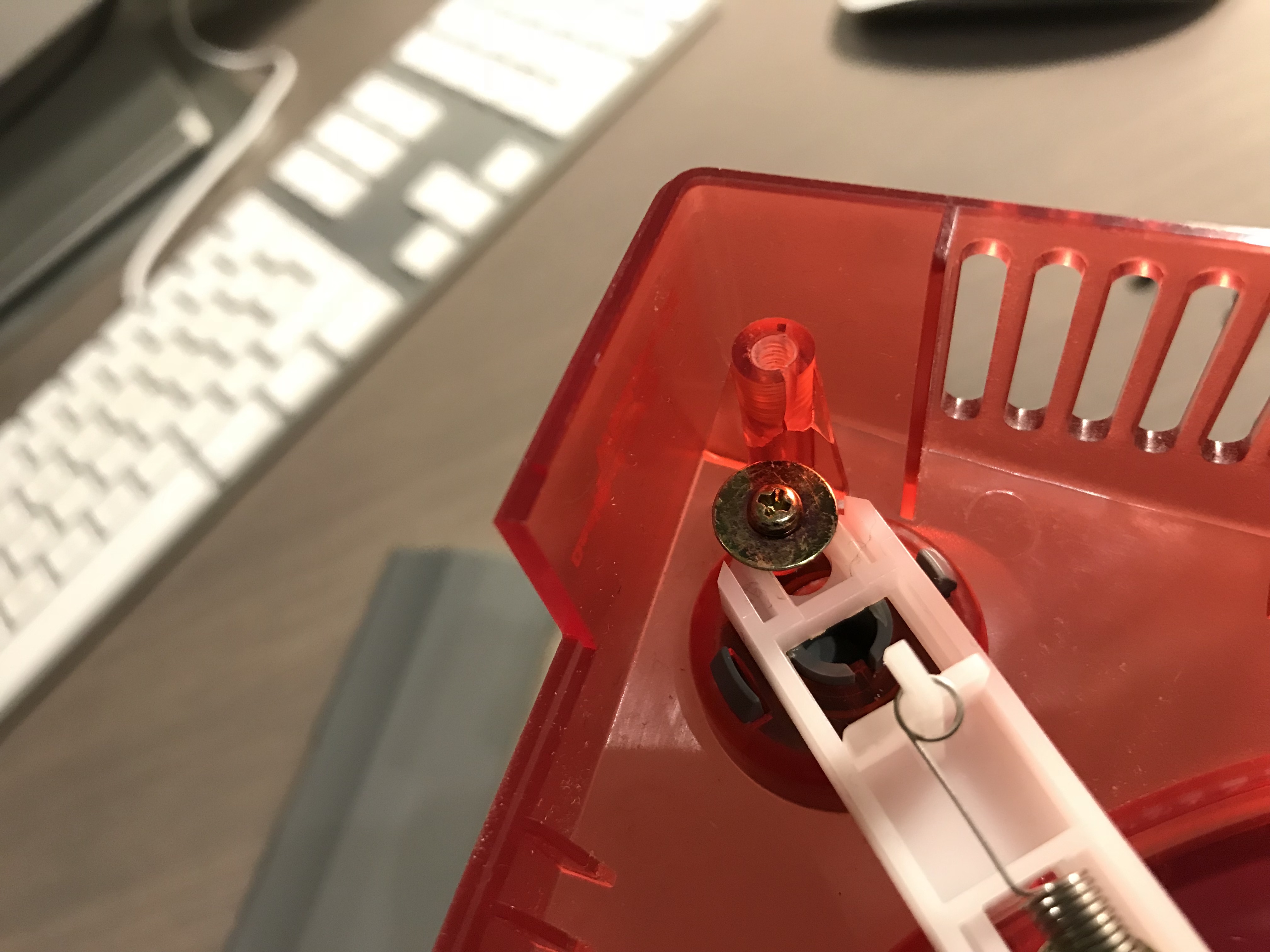

    What would be the best way to fix, or at least improve cracked threads in plastics? I don't think hot glue would work very well here, but maybe some kind of epoxy? I'm looking for something that that's easy to work with. Not so thick that I can't stuff it in the cracks, and not a complete liquid either that would spill everywhere.
    Unfortunately this has happened on my Code Veronica Dreamcast years ago, when I didn't understand how screws worked. The case is translucent so the end result should look as nice as possible :)

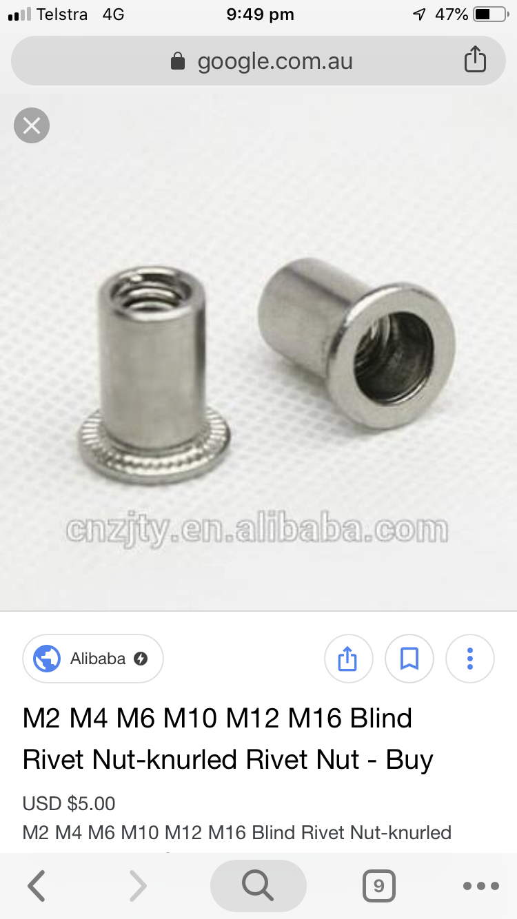

    I’ve seen some bad outcomes when folks have attempted to glue plastics or even ‘plastic weld’ thermoplastics with soldering irons or other hot ends.
    One problem with a lot of superglue is the residue becomes white and can be quite visible.
    I reckon it’s often best to look for a mechanical solution; metal fasteners if possible to place discretely or inserting small nutserts in the shaft and using a narrower screw.
    One trick with nutserts is to heat them after insertion which can bond to the surrounding plastic making a semi-permanent fix.
    Bearking likes this.

    That's a really good suggestion. I might go that route :)
    What do you mean by heating it? Using a soldering iron? I wouldn't want to risk melting the surrounding plastic.
  4. Shane Battye
    Shane Battye Spirited Member
    Oct 28, 2017
    163
    165
    Yep, you apply a soldering iron to the nutsert very very briefly, just enough to bond the surrounding plastic to the metal. But yes, it's very risky in plastic you're not familiar with so I'd avoid it if possible.
    Hopefully you can get away with no further interference to the plastic itself. I'm no expert on restoration but in general with a project like this my aims would be to 1) do no further damage to the original material, 2) find a reversible solution and 3) find a robust solution. Superglues and epoxy resin solutions really only hit point 3 and even then may not be entirely robust. I tend to only utilise them when there's a cosmetic defect - like a cracked part where I have the pieces and just need to piece it back together but your problem here is more mechanical than cosmetic because it's a part that needs to function and withstand some stress. Sometimes just browsing the catalogue of your local fastener supplier will give you some ideas to tackle these problems.
