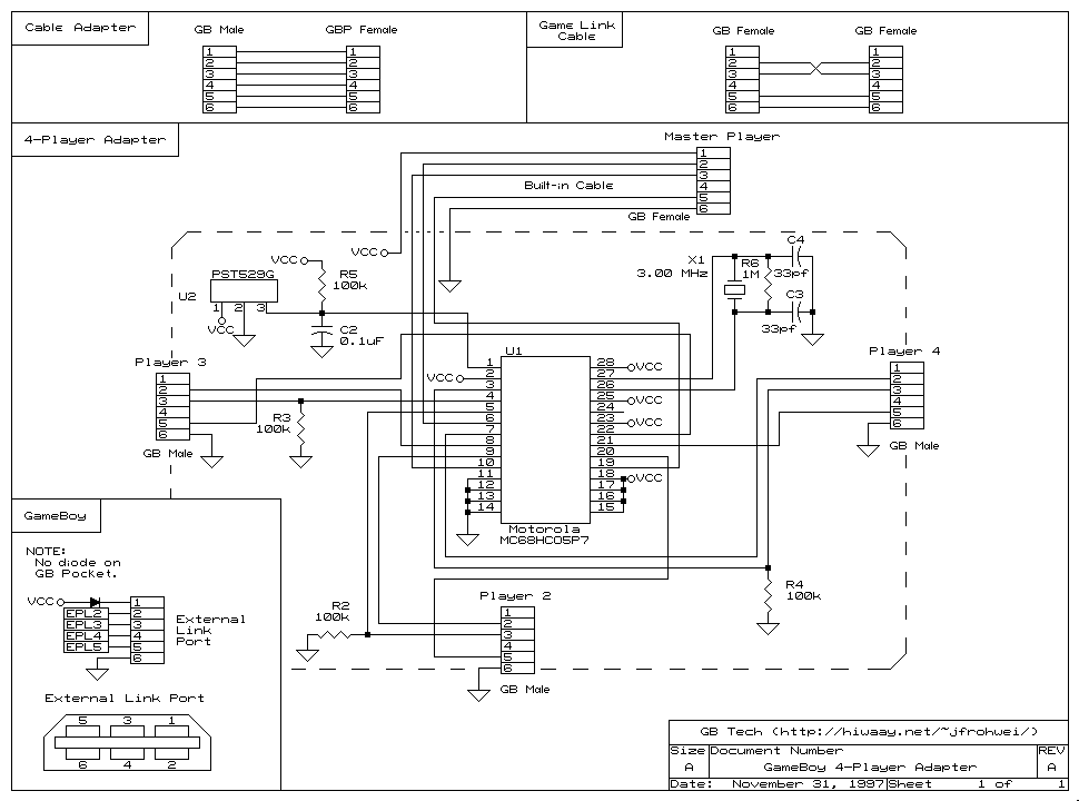

  9. rso
    Mar 26, 2010
    2,190
    447
    Yes, I knew the DMG-07 existed, that's why I asked you to clarify your statement ;)
    And whaddya know, I even found a diagram of its internals just now - Seems like it indeed has quite a lot of internal logic compared to the later ones (not that hard really, since they have none at all). Well, maybe more than two players were something of an afterthought on the GB/GBC, but then big N decded to integrate it into the GBA.
