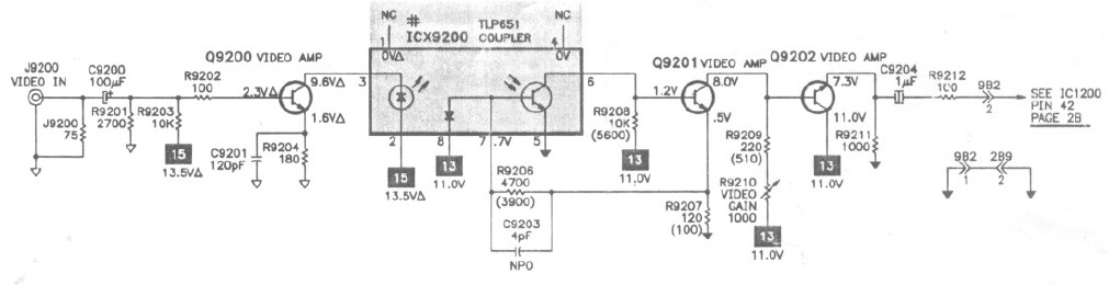

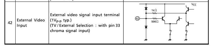

    Hey folks,
    I'm back working on this Zenith TV from the original post for a friend's bday present. I'd like to add composite video to it so he can play games on a CRT at his bedside. However, this is proving more difficult than I thought.
    Pin 33 is supposed to support switching between and Ext. Video input (Pin 42) and the TV stock mode. It says use a 47k resistor to ground thought I found it didn't actually switch (and turn off audio) until I used a 27k resistor.
    Now, I can't get it to show anything using Pin 42 as an input. I've tried stock composite and sync with a voltage divider as well. This IC is screwy as well to me and does all sorts of weird mixing stuff. For example, it looks like Pin 37 may in fact be the video input, and 42/45 are just switching inputs that go through a small amp and then back out of the chip and into pin 37.
    Anyone have any suggestions on how to add composite to this? Here's a picture for reference. Jungle IC is a TA8879N:
    also, according to the service manual, there is a model of this CRT with composite input. It has what appears to be an excessive amount of amplification of the input signal to reach 1V p-p though....what am I missing?
