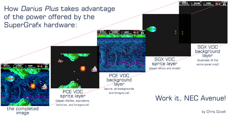

  8. ccovell
    ccovell Resolute Member
    Jan 29, 2005
    954
    I actually did some research on this a while back, and made an illustration that I hope explains it:
  9. ssj
    ssj Member
    Apr 10, 2012
    That's pretty cool thanks.
    I'm a bit disappointed, as I've always seen references to better graphics so I was hoping for some gfx improvements as well, but it's all in the scrolling after all. Good to finally have it figured. Is the difference noticeable in the actual consoles? Like I said I don't have a SGX to test, but on emulators I don't really see any difference.
  10. Tatsujin
    Tatsujin Officer at Arms
    Nov 24, 2005
    3,614
    Funny, so they didn't shift the sprite layer into the
    SGFXs BG layer, but used other elements like the
    score panel only.
    Not much of an improvement, beside the help of the 2nd sprite layer.
    I wonder if the level bosses are also displayed by the
    SGFX sprite layer or the PCE.
  11. sabre470
    Mar 15, 2004
    1,504
    Thanks Chris, very interesting, I can't believe, I didn't check your site first ;)
    I still remember that Axelay demo you did on SGX, epic!!!
