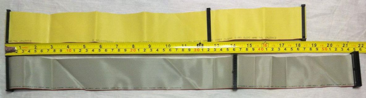

    The stock cable is a 40-wire IDE cable. The alternative is an 80-wire cable. The 80-wire cables are more resistant to interference (and I think necessary for higher transfer rates).
    A PC could have either, depending on the age. You can google for an image to compare them, but it's pretty clear that a 40-wire cable is much courser than the 80-wire.

    80-wire 40-pin ATA100-ATA133 IDE cable vs 40-wire 40-pin ATA33/66 IDE cable. When using a SATA HDD the Xbox uses the higher transfer rates autoconfigured by the IDE-to-SATA adapter. In most cases, the 40-pin cable is not capable of properly transferring data at the higher speed.
    Top: 80-wire 40-pin ATA 100/133 cable
    Bottom: stock 40-wire 40-pin ATA33/66 cable
