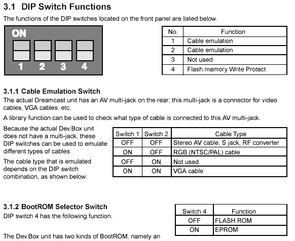

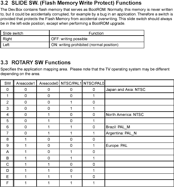

    By the way, how should i set up the DC dev for this formattting/emulation task (I mean, how should i set the dip switches and slide switch)?

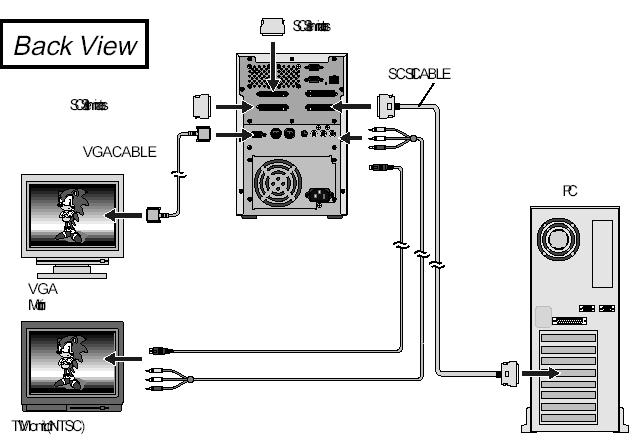

    I just looked into the devbox and couldn't see any jumpers, I suppose scsi hds don't have any (Please correct me if I'm wrong!)
    Here is a setup-pic, if it helps...
    Addition:
    I think the dip switches and slide switches sould stay normal, couldn't find anything in the docs about that. For the rright settings, see the other attacements
    hope it helps...
