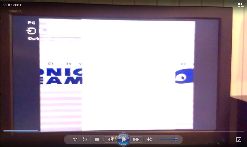

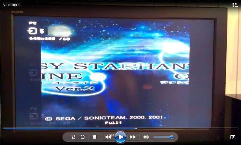

    Update
    Seems to be an issue with my LCD TV not liking the signal from my VGA box...
    I have this working without issue elsewhere and have tested all functions. Not sure what is at odds though, as a laptop connected will display just fine.
    I have read elsewhere that the DC may not output exactly 60Hz so that could be an issue...
    If i switch the VGA cable over after boot I do get a flickering image on screen, but this is pretty heavily distorted:
    Note - the images above just flash up. Its mostly Blank, no sync or blank 640x480/60 displayed.
    Neil
