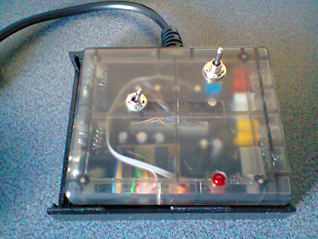

    I also have a Hais Vga box (which I already modified for scan-line effect) and perhaps that could do the trick?

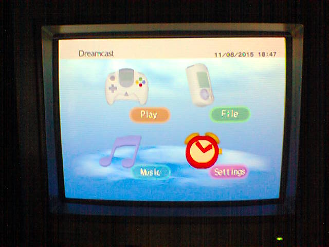

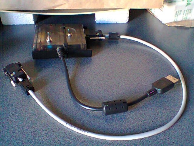

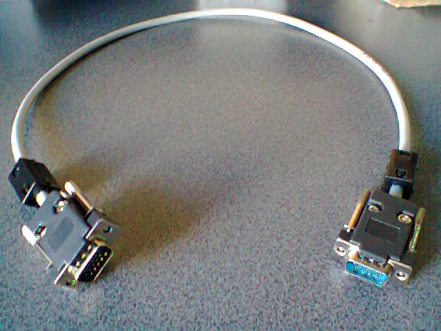

    After installing a 2nd switch to my vga box (disconntecting temporarily pin 6 from ground) and making a cable (HD15 to DB9) I finally get a stable picture on the monitor.
    480i now looks bearable...:p
