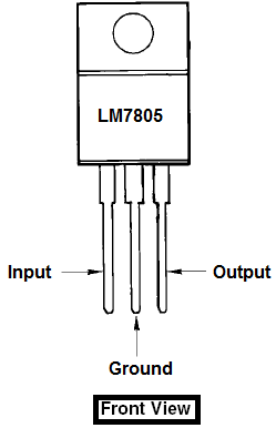

    Cherck your LM7805 and see if you get 5v

    Checked the output. It was 0 but when I lifted it and checked again, I got 5v so there's a short on 5v rail somewhere. I didn't find any obvious sign like bad solder, loose part, corrosion etc. That leaves shorted caps and part somewhere in the system.

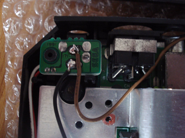

    Last time I had something like, it was the power jack which was corroded and making false contact: I had 10V from the AC plug, and when I was turning the Megadrive on, I get 0V.
    I'm talking about this jack and this small PCB [​IMG]
    After removing the jack, found out one of the hole where the jack is soldered wasn't making the via on both side of this small PCB, and I had to solder the lead of the jack on top AND the bottom.
