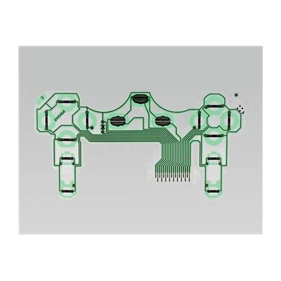

    You could replace that plastic film thing they use now. [​IMG]

    That's possible, but the original doesn't appear to be damaged... Plus, the thumbsticks don't work either, their circuit is separate from the plastic circuit isn't it?
